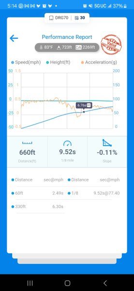

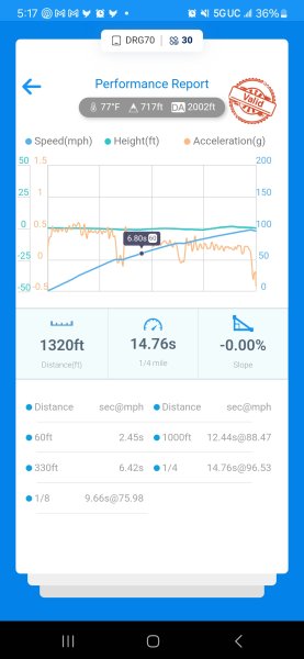

So to get to the point, so far on a dragy I'm pulling 2.5 60ft times spinning through 60ft and my best 1/4 is 14.76 seconds at 96.53mph. Is this what I can basically expect at a strip, and would you guys have any insight as to how much slicks would improve my ET and would it be worth it?

14.7 is what you should get from a slightly better than stock 340 with 3.55 gears
The stick will probably slow you down a bit
Someone else built the car? My guess is slicks will help you break a 14.2 second quarter.
Should be able to get into the 13s..... if everything is optimal

Drag radials will help. MT et streets you can’t go wrong, they are street legal too. That is until you do a few smokey burn outs. :lol: . Its all about getting your 60 foot times down. 1.5-1.6 is what you are hoping for. Hard to get better than that consistently. You need traction. At the track you can get the tires hot in the water box which will help you hook up better. A line lock would help for consistency of burn outs. You can also shave off time by working on your reaction times. The 727 with a 3000 or so stall converter would also give you better times. With 96.6 trap speed you should be in the low 14’s /14.10 ish roughly with perfect RT and a 1.55 60 foot. To get into the high 13’s / 13.7 your trap speed will need to be 100 mph. You could lower gears to get that. 3:90
