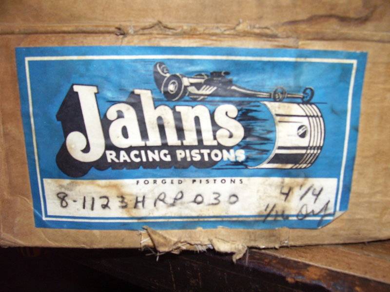

I was ready to try hemi rods, then shave the pistons to get back to the proper quench, then I lucked into a set of NOS Jahns forged flat tops, which saved the day. You never seem to find exactly what you need exactly when you need, but sometimes you luck out.....
good for you
I've used those Hemi Rods and they are HEAVY that plus a HEAVY TRW piston well open up the wallet for a balance job
what's the ch on the Jahns? did they come with the clearance info?
They came with very little info. All those parts are at the machine shop (a little past arms reach). I'll plan to post more info including the comp hgt and other details about them and that 426 wedge build late this fall, maybe into winter if its mild enough. Lefty71
If you do not have the place to make the measurement on the piston and the measurement I'd start a new special thread
I can ask down at the shop if no one responds I sure do not remember- do know Fordgetrue :)
I have everything I need to measure, except the parts aren't here right now.... I'll start a thread soon, thx Lefty71
