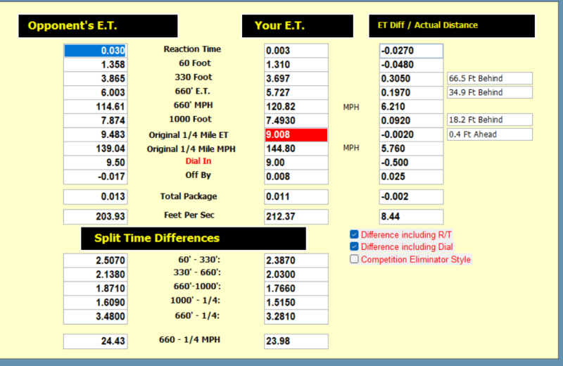

The 2.33xxxx at the bottom is sometimes listed as M.O.V., .margin of victory. It's the difference in e.t. between the cars, with reaction time added (or subtracted) in, During a real race with dial in, the handicap is figured in too.

I entered your tire( 27”) ,your 3.91 rear and the 727 gear ratios and this is what Wallace calculator came up with. You can get lost on that site for hours playing with this stuff.
Here is a screen shot of a close to ideal run at 90mph according to Wallace. The second chart is based on the 7.72 ET. Personally I find their 300 and 660 times a little optimistic. But they give you a better idea of what to strive for.

I put this in a seperate post. This screen shot breaks down exactly what is happening in a bracket race time slip.
