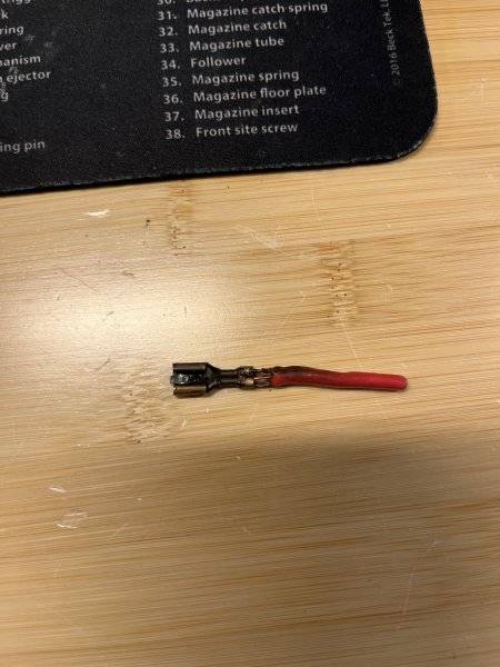

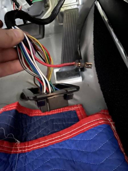

As an add-on to my other thread re:fusible link burnt, I have traced the problem to my new engine harness from Evans Wiring. After I sorted everything out in the engine compartment, I went under the dash and immediately saw that the power wire was melted at the bulkhead. I pulled the bulkhead out and removed the burnt wire. Then noticed that the fusible link was feeding into a violet wire and the violet wire directly above was feeding into the power (red) wire. That seemed odd so I pulled out my original harness and compared. The new engine harness was set up wrong!
The violet wire and fusible link were switched around. Now I’m just waiting for the right female connectors to come into the parts store before I can fix it.
Could that be why the dash and interior lights weren’t working?
Another restoration lesson learned, I should have compared the harnesses before installation. Evans had good reviews so I guess I just trusted it.

Violet wire is usually low beam headlight.
Definitely don't want the charge load going back through that!
The weird thing is the car ran, I took it for a test drive…had all exterior power, lights, wipers etc but no interior lights, dash etc. I guess the wire was slowly melting?

I just emailed him and told him the issue along with pics. He responded within 30 minutes or so and said it shouldn’t have started or melted the violet wire. At any rate, he said to send the harness back and he’ll fix it. I just asked him to send me a new fusible link since I already fixed it.
I should note that I had to check all the connectors as some were loose and could be pulled right out of the plug. It was a quick fix.
