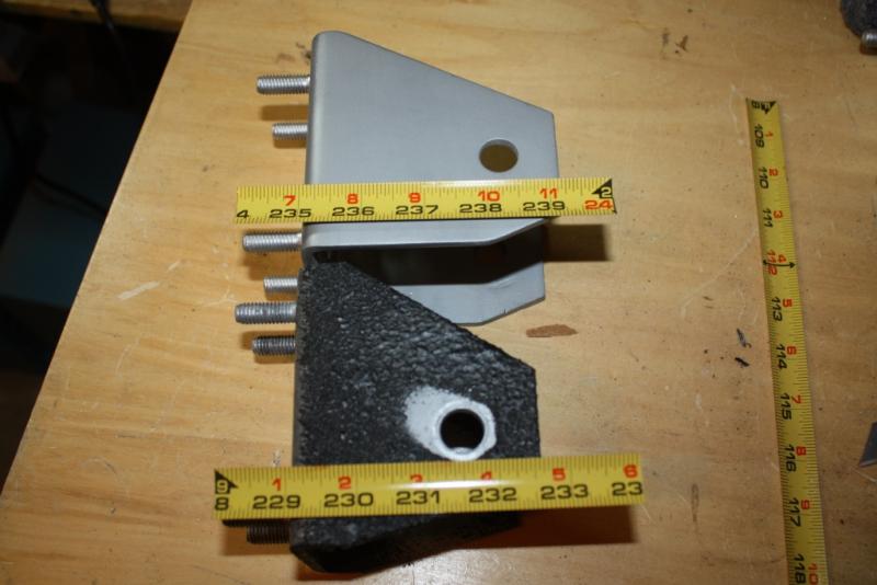

Hey, Gang...
I am trying to locate the exact dimensions of the shackle mounts and the length and number of leafs on both sets of leaf springs for the '69 Coronet R/T. HELP!! :yes:
This is what I have. It should point you in the right direction.
Left rear spring, 6 leaf, part number 2539795
Right rear spring, 5 + 2 – 1/2 leaf, part number 2539965
Depending on the arch of the spring, you will not have an accurate dimension. These numbers are stamped in the bottom leaf.
Front shakles are shown in the picture below. Dodge (3.25") are longer than Plymouth (2.50") to center of pin.
Hope this helps you out.
