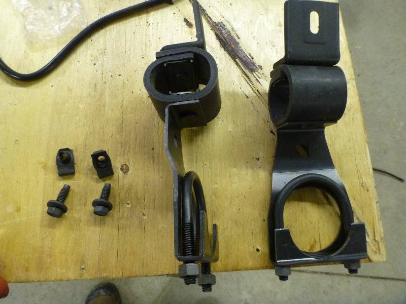

Hi, on a factory exhaust clamp what would the finish have been In 68? I see some of the reproduction systems out there have bare steel and others have nickel plated. Which would be correct? Thanks!
As far as I know, Black oxide or phosphate is correct. I got these from Frank B, certified judge.
