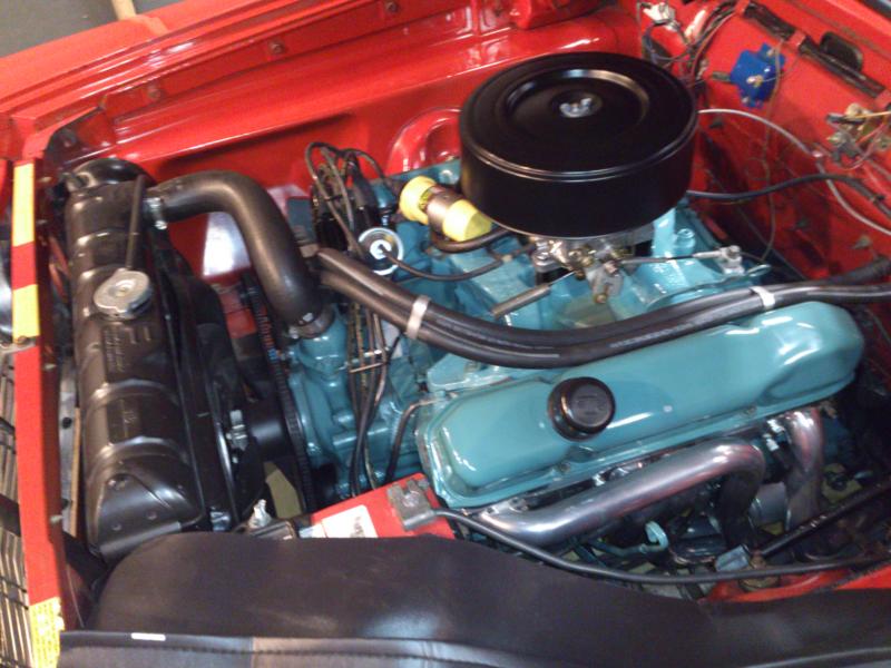

And I didn't even use header or collector gaskets. Just high temp orange silicone.[/QUOTE]
same here....no gaskets just Hi Temp Orge Sili'
:icon_cherry: DSC_0071.jpg
