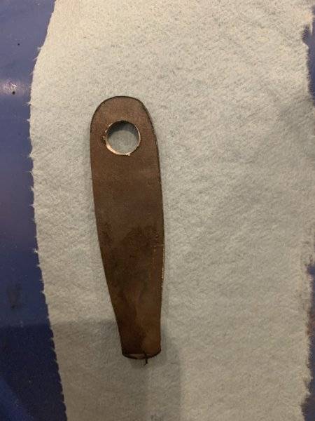

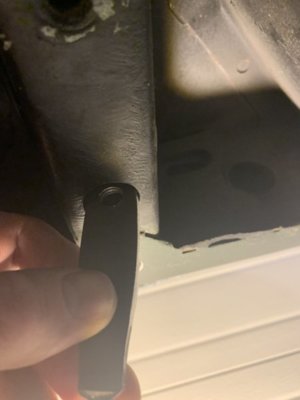

I first widened the hole in the frame rail just a bit with a step drill, one between the 2 threaded nut holes that the bracket goes on. I used a wire to fish out the old broken bolt and the original nut that was welded on inside the frame rail. They came out as one piece as the nut gave way from the frame rail (PO).
I then took a piece of flat metal bar and made it skinny enough to fit through the hole. Then drilled and tapped a hole that was the thread size of the bolt. Then slipped it inside the rail. Lined up the hole...and Voila! The bar acts like a wrench that when the bolt it tightened it goes up against the rail and then the bolt pulls it down tight.
It’s all hidden. Again not judge worthy...but got the job done and the bracket is securely in place. I did this first as I did not want to drilled down through the trunk. The area is also directly below the bracket the reinforces the bumper bolts. So did not want to disturb that. Again...crude. But hidden. And secure.
