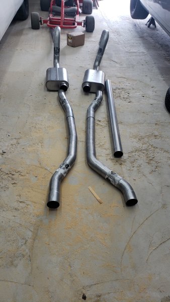

I make my own with pipe kits from Jegs and Dynomax Ultraflow mufflers. I have time and don't want/like to drop my car off anywhere.
Last kit was 3" B Body.

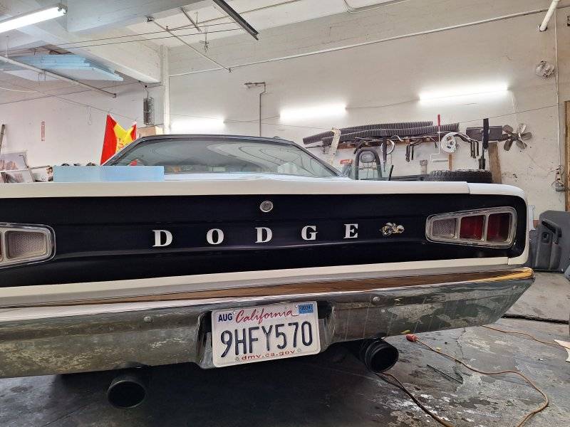

Coronet Superbee tribute. I did the exhaust myself. I bought a kit from ebay 62-74 Mopar B Body Car 2.5" Dual Exhaust Kit 2 Chamber Rear Exit No Tip | eBay
And the tips from amazon Amazon product ASIN B09J226BCBI bought a 10 foot piece of 2.25" tubing from Napa that I formed with an s bend to go from the headers to the mufflers.
I turned out very good. A little too loud but really sounds great.

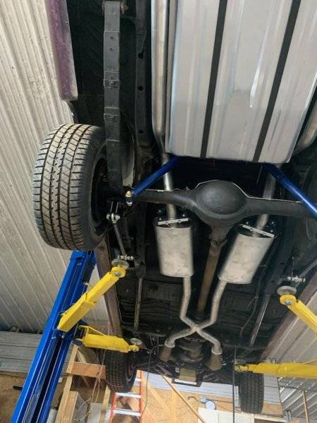

I used to run headers, sidepipes, etc. in the day and loved it. But when I got my 70 RR, it was in need of a new system. So I got the ECS (their "factory authentic") pipes and mufflers. Sounds like I'm transported back in time. :)

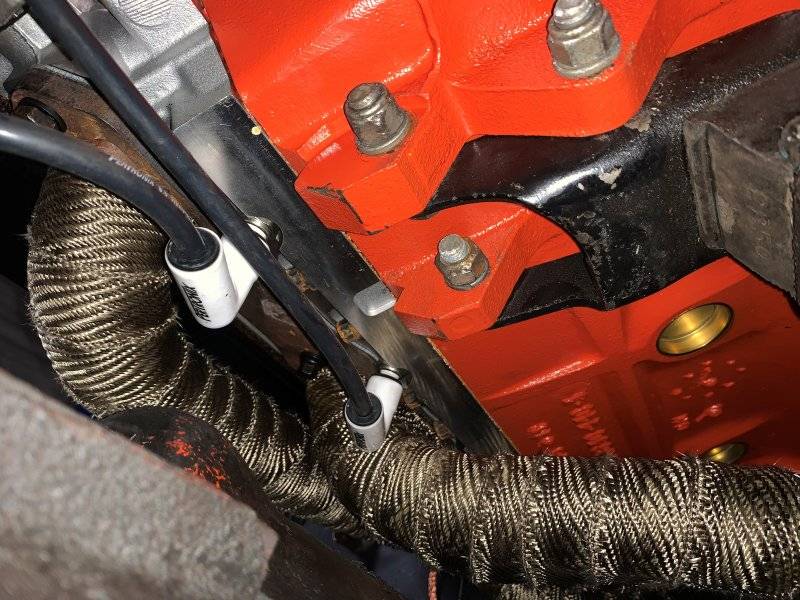

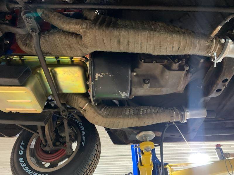

Might as well throw my hat in the ring as well. I have a 440 based 512 with a dual quad tunnel ram setup and run the TTI headers and a TTI full 2 1/2 system with dyna flows and an x pipe. Motor dynoed just under 600 HP I have had no indications of restriction ( I chose a 6000RPM redline) The only difference that i have verses the norm is i wrapped my headers and love the benefit of almost 50% heat reduction in the engine bay, (comparing my buddys car to mine with a temp gun) I have heard this also increases exhaust flow because of higher exhaust temp in pipe. I don't think my application is quite at that level (I'm not chasing that extra 10th in the quarter) I am aware of the added corrosion issues of the wrap but the purchase of the stainless headers from TTI will help combat that. Good Luck!!
What wrap did you use? Were the headers ceramic coated? Thanks
these are the wrap and headers that i have.
Design Engineering DEI 10095 DEI Titanium Exhaust and Header Wrap Kits | Summit Racing
https://www.ttiexhaust.com/TTi383440-134.htm
I have to say I am very happy with this wrap, the trick that i was told with wrapping (and it worked well for me) is to soak the wrap overnight in water it will become more plyable then when you stretch it over the pipes and secure it it will shrink and form to the pipe creating a better longer lasting wrap.
