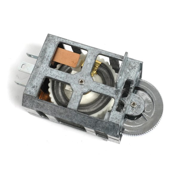

Hi,
I was curious to know people's experiences with the OER dimmer switch (part number MB16951). I recently ordered one from a supplier in Sweden and was quite dissapointed with the quality of the product. Firstly, there is a lot of play within the wheel itself, making it a bit wobbly and cheap feeling. It is also a lot harder than my old one to turn the wheel and really squeaky when doing so. Compared to my old oem one (which stopped working) this feels a lot cheaper (despite the very steep price).
Have I gotten a poor sample, or is this to be expected from the reproduction parts? If I decide to keep it I might be able to make it easier to turn the wheel by just lubricating the mechanism. Does anyone have any tips as to which product to use that won't cause any issues?

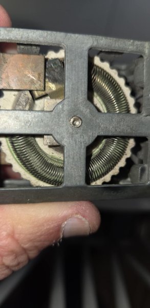

The biggest issue with OE mopar dash lite rheostadt is its wire-windings
get oxidized making poor/intermittant contact. By pulling it out and cleaning the
windings, coat it very lightly with dialectric grease . And re-install...

of the OE mopar switches can be rebuilt by taking them apart, cleaning the contacts
and coating the contacts lightly with dialectric grease..

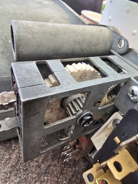

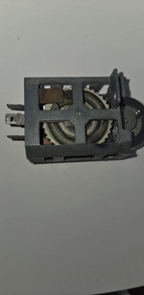

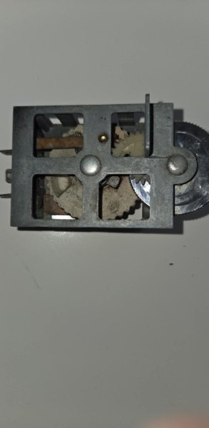

Depending on what's wrong with your current one, it can be fixed. I took mine apart, epoxied the rheostat winding into the wheel, cleaned contacts, and put it back together. New, replacement parts are disappointing.

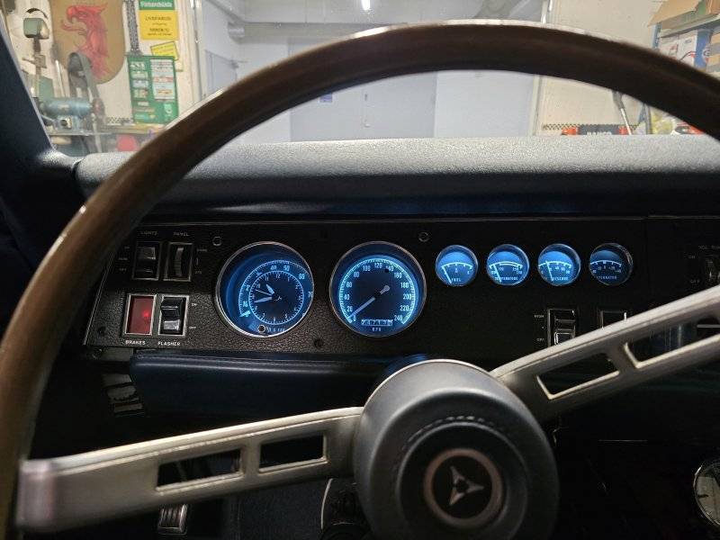

Thank you for the replies! My oem unit doesn't look too bad, but it is oxidized and doesn't give the expected readings when measuring it, which I believe is why my dash lights aren't working.
You've encouraged me to maybe just try to fix the old one. Did you drill out the rivets and replace with screws, or how did you go about it?
It's been a while, but I used some flush cutters to uncurl the small end of the shaft and pulled it out. Put it back together and tapped the end back down.
@threewood Thank you for the response! That sounds promising, so am I understanding you correctly in that you basically used the cutters to form the part of the pin marked in red, so that it fit through the hole and then at the end, tapped it with a hammer to make it wider than the hole again?

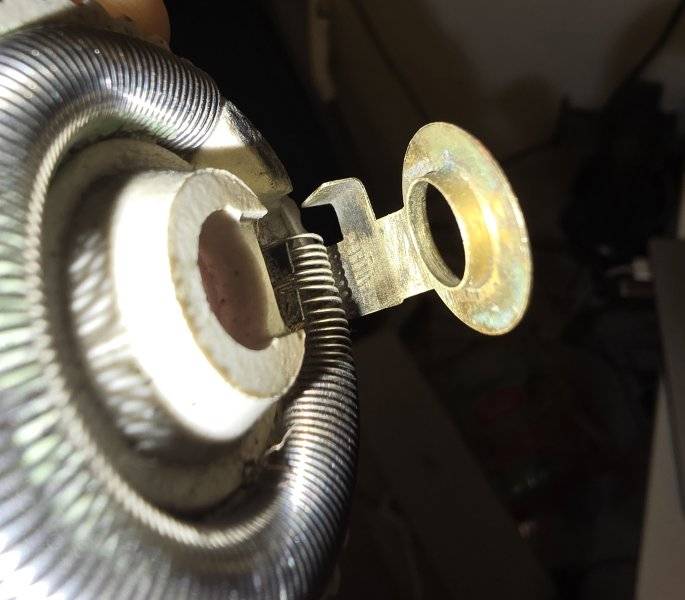

Sorry for the potentially stupid questions, but also once it's been disassembled, which areas of contact should I be cleaning? I want to avoid messing too much with it, to avoid breaking it. The dome light works, but as mentioned, not the gauge cluster lights.
Thanks!
Yep, that is correct. If you end up having to cut it off, a replacement piece could be made or found.
