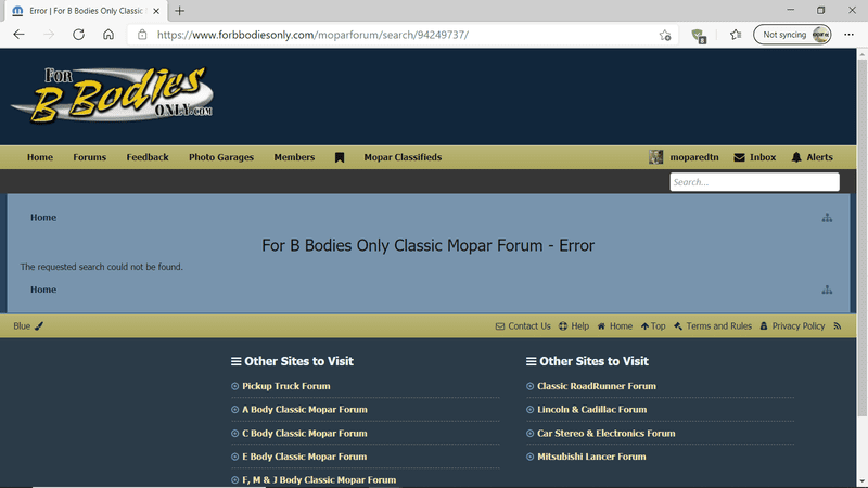

It’s just coming up as an B-Body forum error on my tablet. I’ll try later on a laptop.
Link seems to be bad.
Yup...
