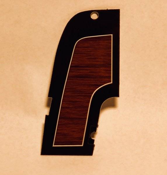

Has anyone who bought a set installed them, yet? If so, please post a how to video or pics. Especially, for those of us with no fabrication or body working skills since these are flat and need to be formed to the bends in the dash frame.
P.S. This is not a knock on the quality of the dash parts. They look amazing! I just don't want to install them using my traditional 'trial and error' methods.
I've only sent 2 full sets out and am anxiously waiting for pictures and feedback on installation. @FURYDAVE is probably our best hope. Maybe we can convince him to provide photos and a how-to guide on installing them. He's going to lay eyes on them for the first time tomorrow. FINGERS CROSSED he likes them.
The other set I sent out hasn't been installed yet but @Moparbill70 seemed very stoked with them.

Dave, if you have ANY criticisms, complaints or concerns please state them here. This has been an ever changing and evolving project and I'm open to any and all feedback. Don't pull any punches.
@lanceh13 only received the radio delete bezel and I don't know if he has installed it yet, but he was seemed happy with it.
Ken, I'm very happy with mine honestly. I haven't gotten it installed but it should be installed very soon. I did do a quick test fit and I think the finish came out great. I could very easily go with keeping the originals and using the one you provided but based on quality alone I'll be purchasing the complete set and swapping out my remaining originals.
These are truly high quality reproductions and I think the fact that you did something one off when everyone else has been turning me away has truly swayed me so again thank you for the passion you've shown for our hobby and even tho my guess is there are only a limited number of these needed you still jumped all over it and made it happen.

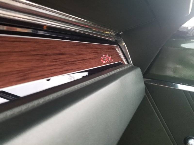

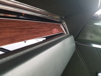

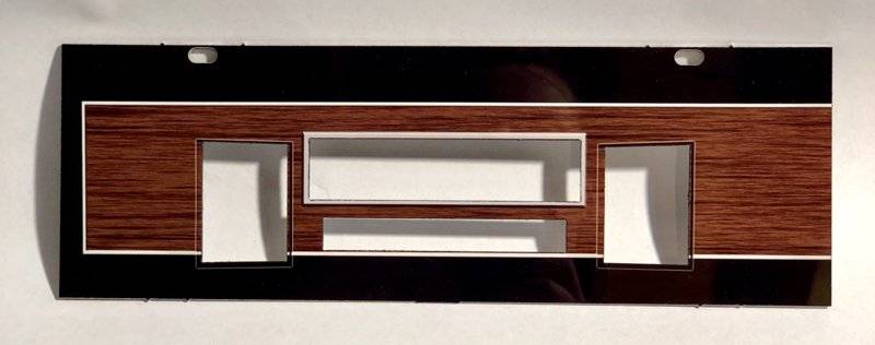

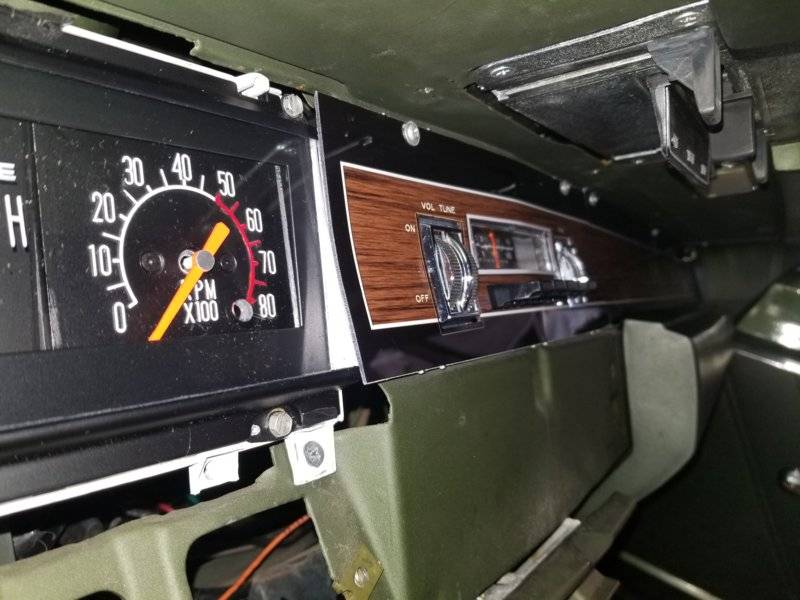

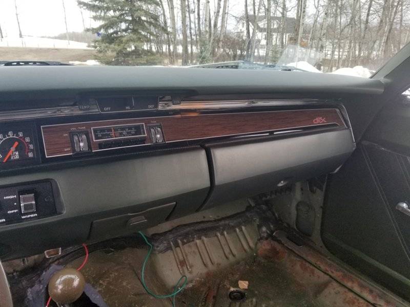

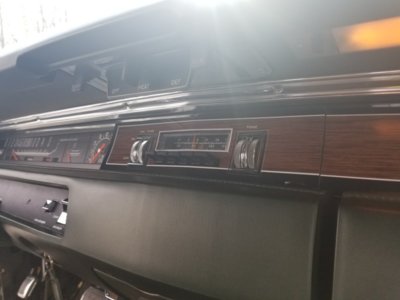

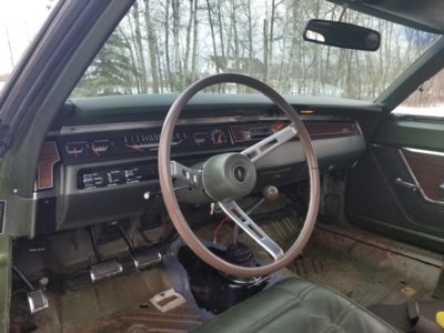

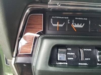

Sorry for the late reply! Lots of work going on. Finally got the trim installed from SoCal440GTX. Very very nice stuff. These are NOT reproductions they are upgraded replacements. Way better design then factory and take a ton of abuse and flex.
At first glance seeing them out of the box (they come shipped flat for safety) they almost look like something for a model car when compared to the originals. Boy was I wrong!
After shaping them and installing them they fit and look perfect. They are very bright very shinny and super tough. Ken has spent alot of time mastering the fit and it shows. Very little was needed to get the install right, any questions I had ken responded immediately.
I found the best way to shape them and get the factory curve was a piece of 2.5 exhaust tube wrapped in a towel. Light pressure and a few bends came out great. Super easy material to work with and very forgiving if you make a mistake ( I made a few). If you have your original parts. Just keep bending and shaping till them match up.
Took a ton of pics. Freshened up the dash and really makes the interior pop.
Thanks Ken! Need more great people in this hobby like you taking the time to make a great product
If any more pics or info is needed would be glad to help.

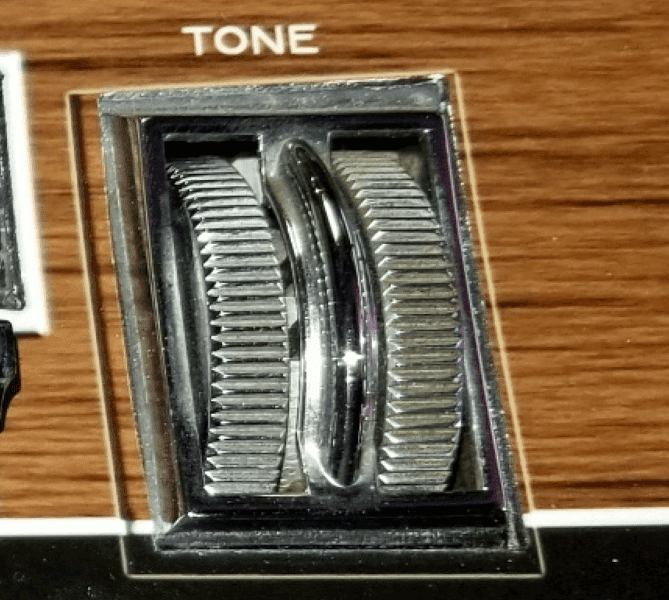

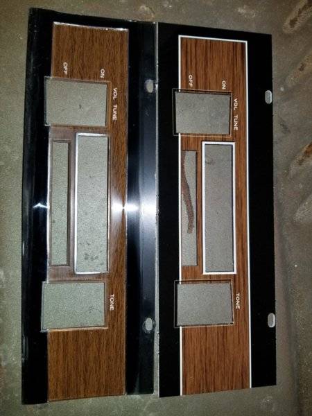

Ken, that last pic of the back of the radio face plate shows the top of the opening on the left cut at an angle. Will this be fixed on future sets?
Dave, nice job. Looks outstanding!
No, that's how they are supposed to be, trust me. I thought that myself at first. I even considered squaring them up anyway, but research proved it is necessary due to the angles and protrusions.
The Repop face plate does have smaller and square holes, which is another reason I considered squaring them up, but the repop does not match originals.
I have an 8-track so all this is based on pictures and speaking with Dave, no first hand knowledge. If you've got a different faceplate with square openings please post a close-up picture and take dimensions with a caliper.
