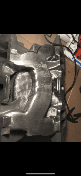

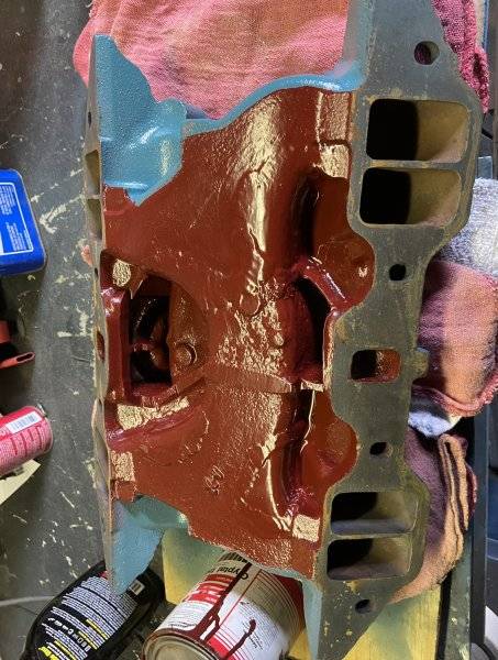

The stock intake is a huge impediment for making real power……..especially when coupled with exhaust manifolds.
A pump gas, truly street friendly HR cammed combo will be very lucky to get close to 500hp.
Especially if it’s cammed properly for the low cruise rpm that would accompany tallish gears and an OD unit.
Probably end up closer to 450hp.
To put it in perspective……
Low deck 511, ported 906’s(280cfm), 12:1cr, .630 lift solid roller, reworked 301 manifold, Ede 800AVS, HP ex manifolds…….525hp on the dyno.
11.58@117 @3670lbs in a 69 Bee on bias plies.
