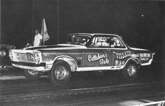

I read a article years back on a 1962 383hp rated 343 stocker special used in NHRA..... anyone knows about this? still have a few pics....
