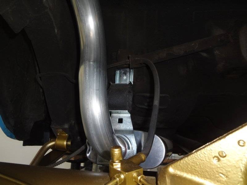

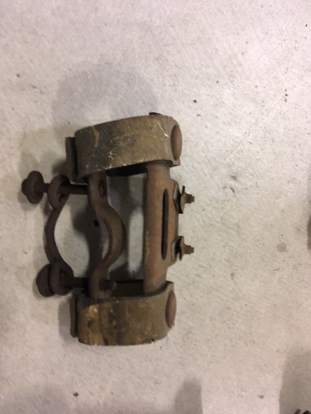

 Here is the E-body bracket I installed. It was too long. I rigged it somehow... don't remember what I did to make it work.

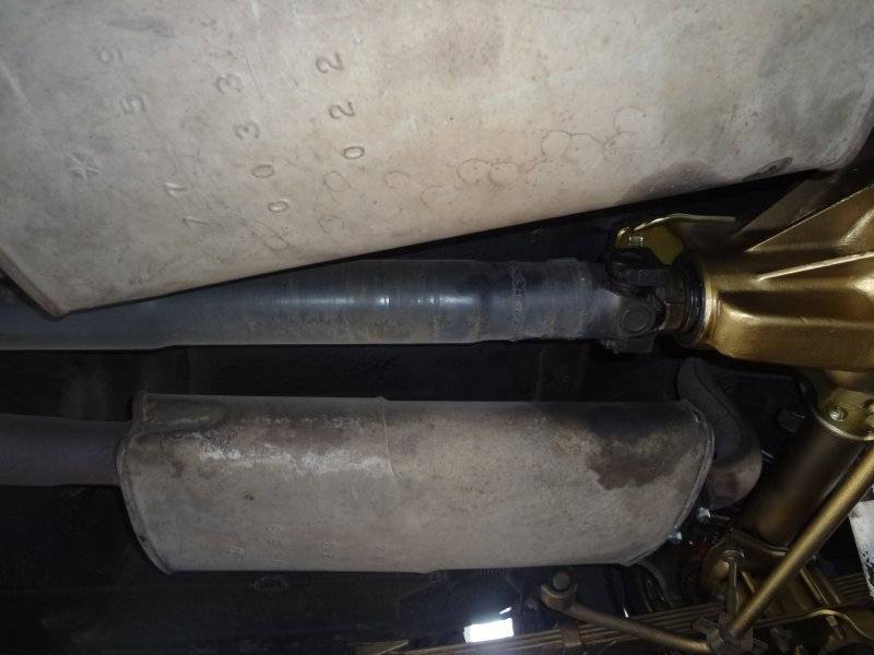

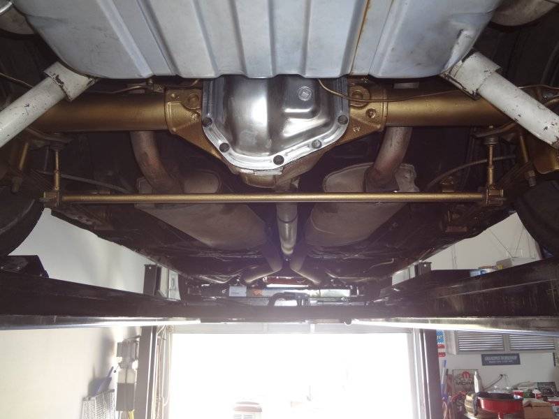

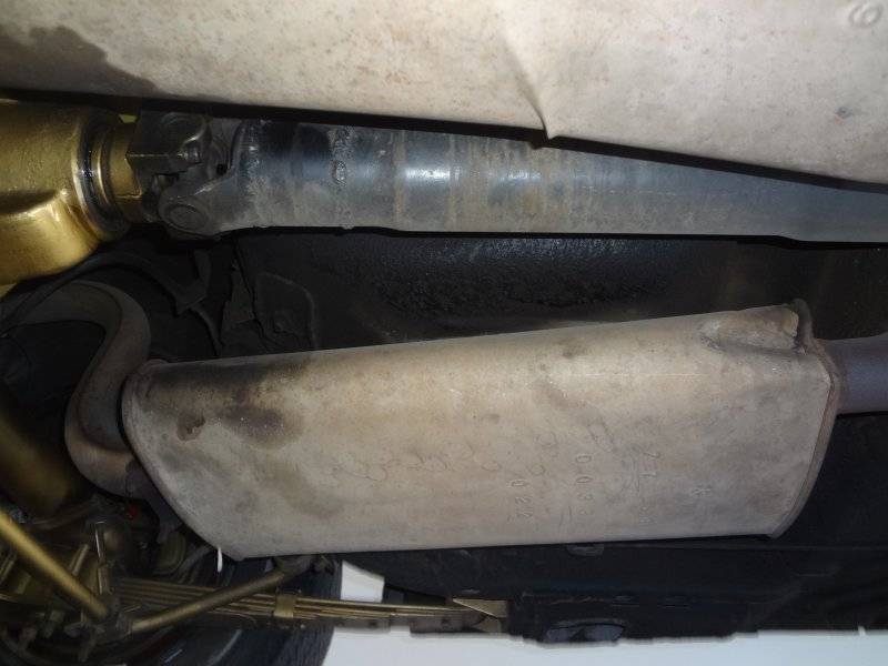

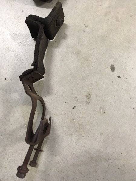

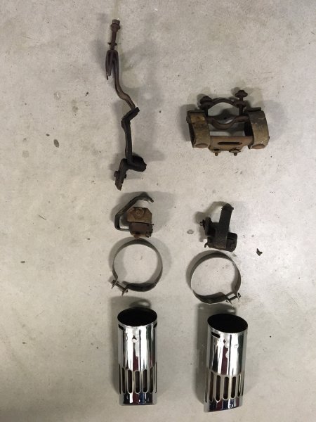

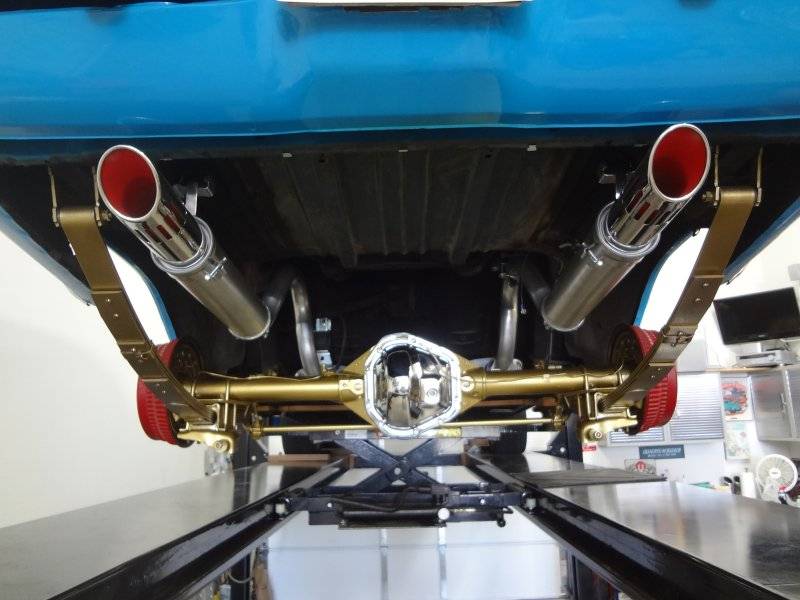

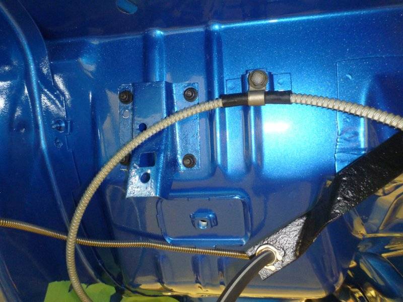

I might be late to the party. But, here's pictures of my 73 Road Runner with factory exhaust. I also went with accurate exhaust when I restored my exhaust. Hope these pics of the original brackets help. I believe they are the same as 72.
