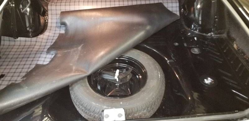

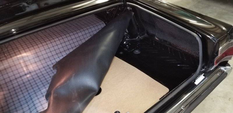

This is what a 67 looks like in the trunk. Somewhere I have pictures of the Superbird trunk area, but I can't find them right now. If you have an original or reproduction trunk sticker for your car, the layout will be shown. Also reference a service manual or owners manual.
View attachment 1524717View attachment 1524718
On the 67 the redline was was down, because the jack base and jack hook are in the dished side of the wheel with a threaded hook and a large wing nut. Then a spare tire well cover goes on and with a cup with a small wing nut securing it.
On the 70 Superbird which would be more like a 69, the white letters are showing when you open the trunk.
On both cars, the tires are mounted on the rims where the RWL's or redlines show correctly when mounted on the car.

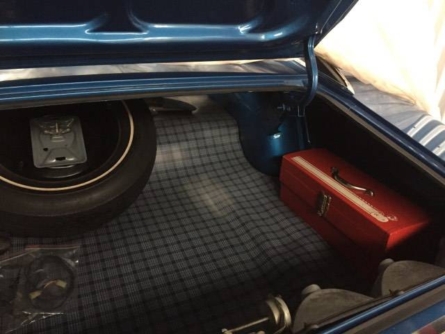

The WW tire looks great in there, nice looking trunk.
Thank you mine came with white walls on the 500 road wheels but the spare was a standard steel rim.I also have the original scat pack tool box in there
