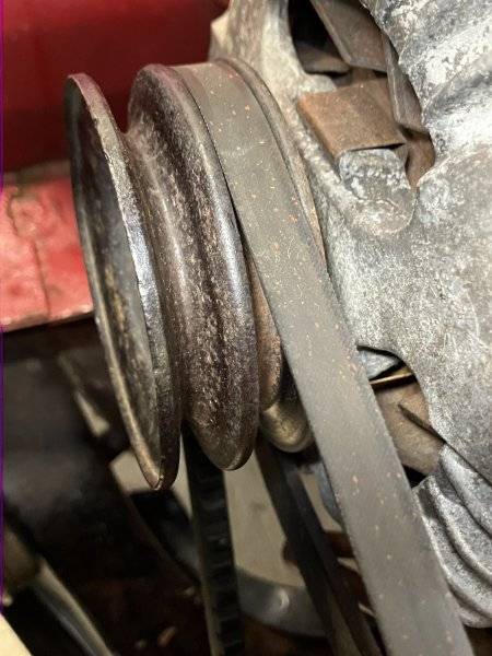

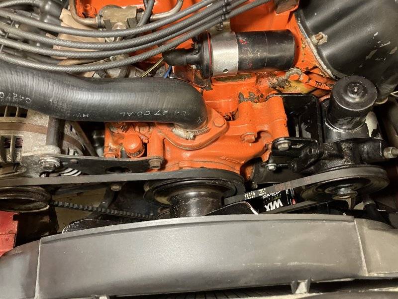

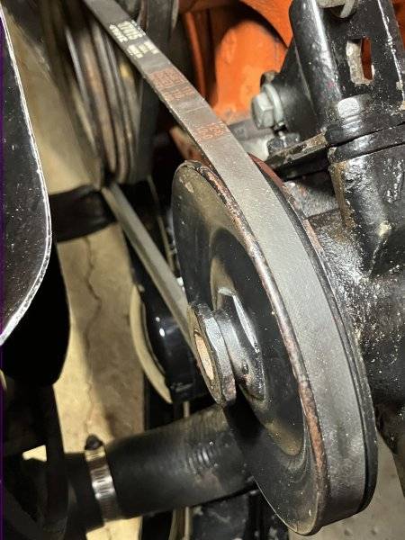

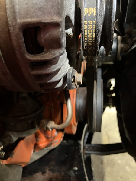

Not sure if you can tell from the picture if my pulleys are original. From checking around I believe the os pump is TRW. Both belts are same width. Changing them out since it’s a new ride and I have no history at all - cheap investment. Thanks.
Take a couple close up pics from the driver side showing the fan and ps pulley with belts that you have. The ps pulley should be quite a bit wider than the fan pulley. Try to get a pic of the crank pulley also. Call my number in the PM and we can discuss it farther.
Sorry. Guess these would help. :jackoff:
Let me go to my desktop to see larger pictures. It appears you have the correct pulleys. Your ps belt says 17415, but looks to me to be a 15415. and your fan belt appears to be the 15 series belt also, which is not the correct width. PM me for more details.
