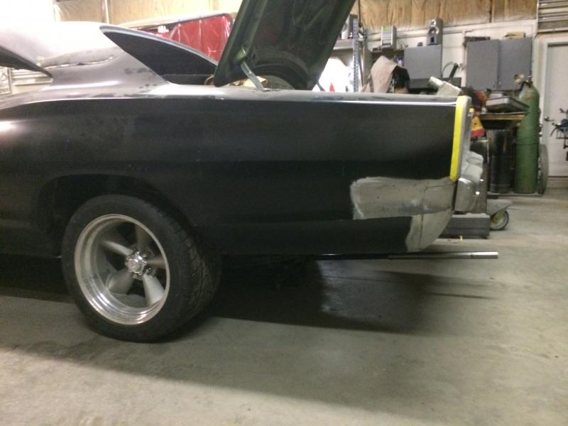

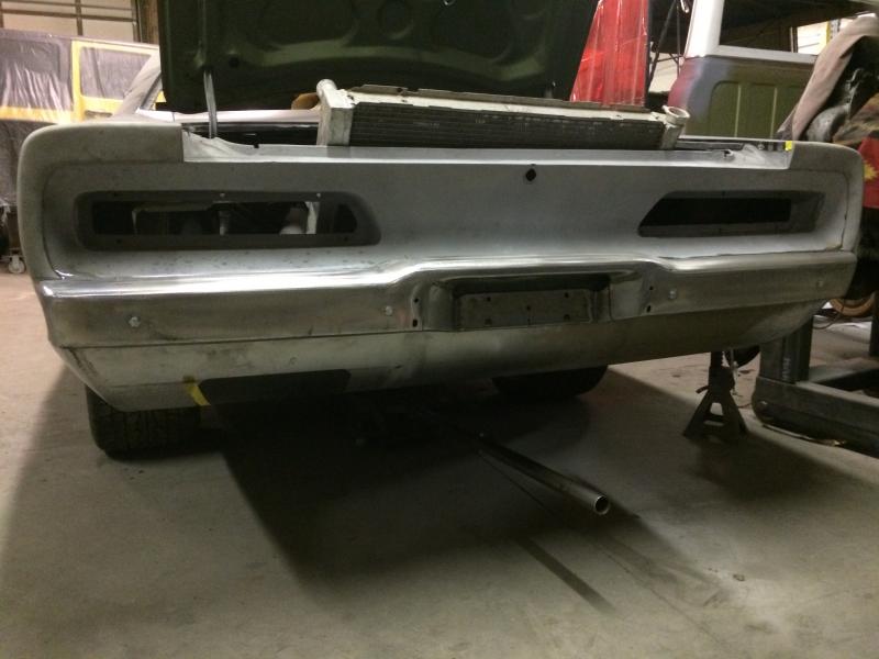

on my car i replaced the rear superbee bumper with a charge bumper as in the picture
will be fabricating a new gas tank with a neck that is filled through the trunk. i am trying to go for a very sleek look with no turn singles or gas cap on the quarter pannel
