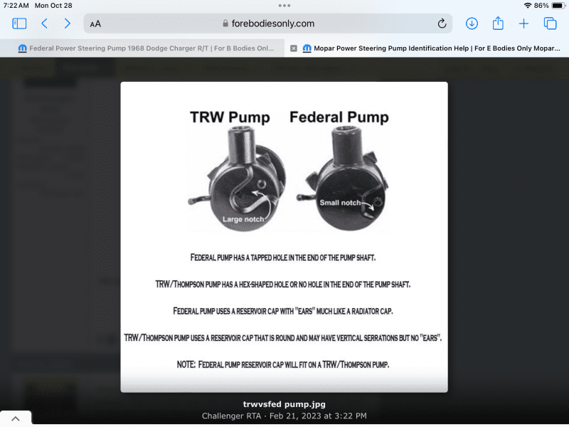

I thought that my only choices was Federal and Saginaw. I checked Chrysler Online and from the pictures there and other posts on this forum, I may have a TRW pump. At first glance, my shaft does not have internal threads. Chrysler Online price for a rebuilt TRW is about twice that of a new Federal Pump.

No not what I am saying. I was assuming from your first post you have a federal pump. I was making the point that year of federal would not matter. Saginaw, TRW and Federal have different shaft diameters so pulleys don't swap. A TRW has different mounting bracket and specific pully for a 68 application that had a TRW pump. If your pump is bad get the same pump type.
If you have a Federal pump get a federal pump.
Sure you can go and install a Federal Pump in your 68 big block but engine matters. Hemi pulley different than 383/440. You would need Federal BB bracket, appropriate pulley which has to work with your crank pulley, and hose. Gets a lot harder to do that unless you have a pile of stuff to try.
So which pump do you have? Pictures help.

OK, Now that you have done a good job in straightening me out. I guess I do Have a TRW pump. And, the best approach from here is to rebuild it, have it rebuilt, or get a new one if at all available.
