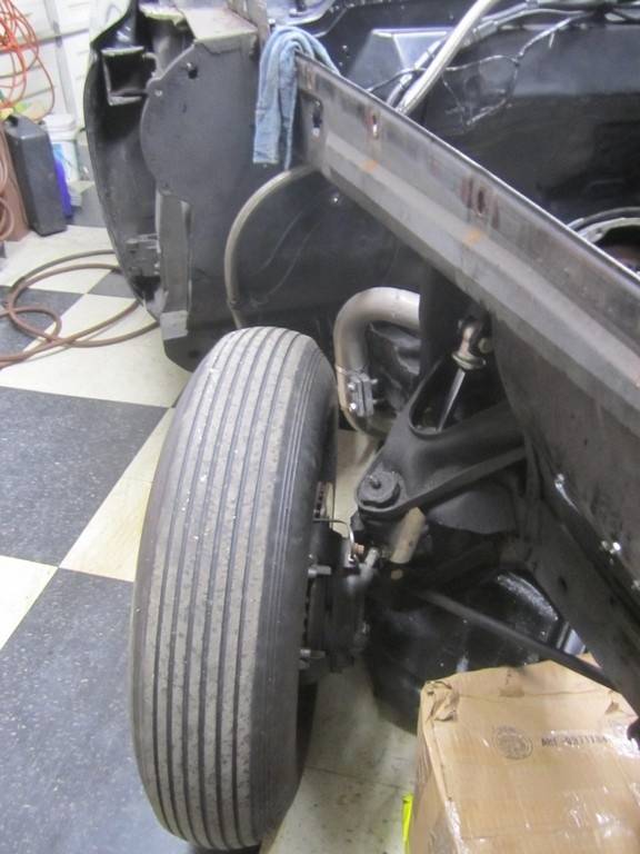

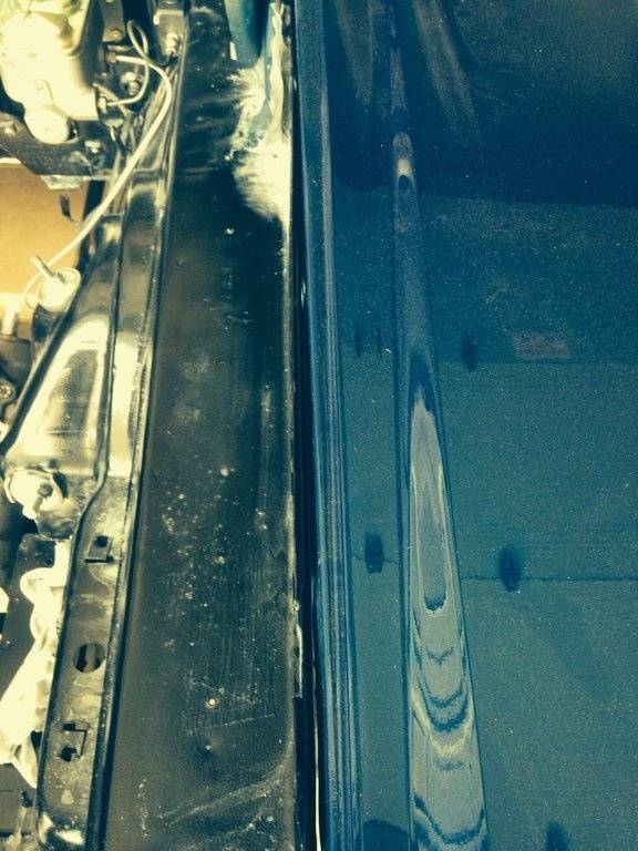

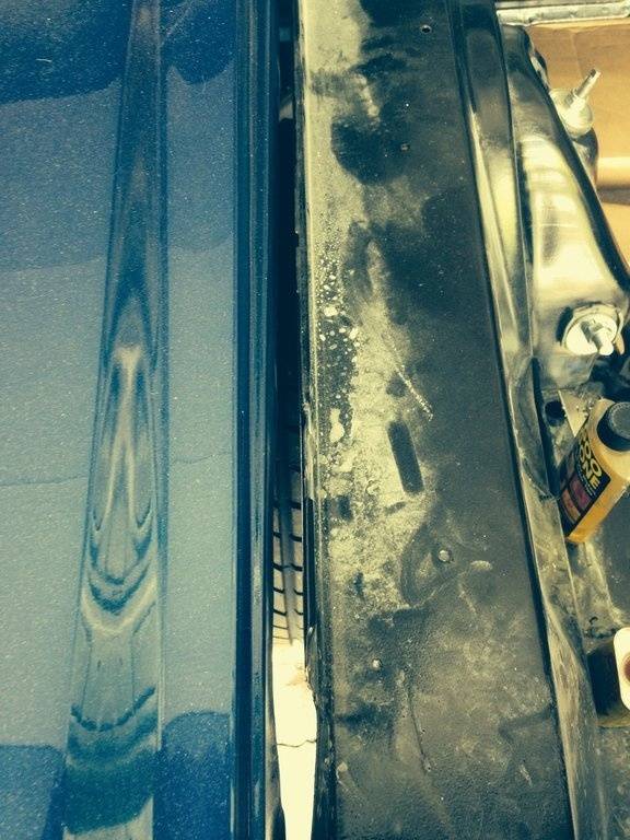

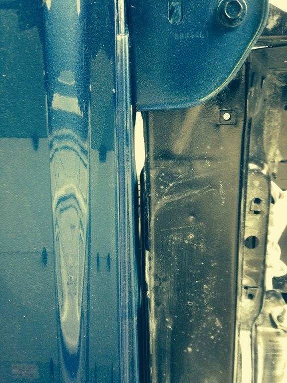

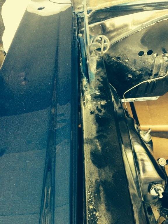

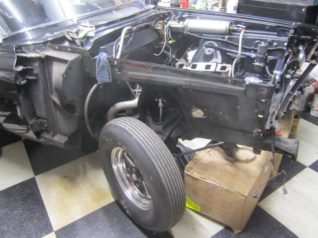

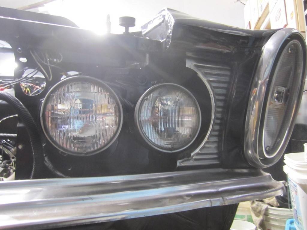

Here's pics. At the widest the gap is 7/8 wide. Cowl gap, door gap and hood gap is perfect. Will the inner fender flex over to the fender when I bolt it down? Thanks. Erik.

Mine do pull over to the fender edge when I tighten them up. I suggest you put the bolts in and tighten them in sequence a few turns at a time and watch closely to see what transpires. If they don't I expect you will have to get the fenders closer and then readjust the door. It's not only the gap that's important, get a long straight edge and look down the side of the fender/door/quarter and see if it is all on the same plane or not. If all is flat all along then I would suspect the car has been hit before or it got out of whack while being restored maybe? good luck and let us know.
Did you check the alignment of the panel surfaces first? I mean, the gaps could be right but the surfaces jacked in or out in relation to each other, and compounded as you move forward down the length of the body, thus accounting for the gap you see in the inner fender lining up.

Now I see the issue, the apron or inner fender can be persuaded with a few taps with a hammer. Go slow and it should line up. A little gap here and there is the factory way. I have a little on my 68 not a big deal for me. Unless you want to over restore as mentioned.
Not sure why the gaps were not set prior to blocking it out. That's when I would have been doing it. Set the gaps and assemble the nose, then prime, then block, then blow it apart to paint everything, then reassemble. You'll probably mess up the finish on the fenders by pulling them down like that.
