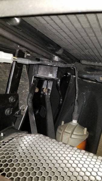

Went to a cruise in last night and on the way home i pulled the headlight switch on,the right fender indicator lit up,but the left did not.Ever when the parking light are on same thing,left and right do signal just fine,also at the dash cluster the right side indicator glow green,but the left is dark, thinking headlight switch,anyone run into this before. thanks gents.
Check the ground to the right front turn signal/park lamp housing. Normally grounds through the mounting screws to the valance.
well i wiggled the wire to the right side signal/park lamp,it works now and the dash light is off ,but now when i pull the headlight switch to the on position no turn signals wtf could it be . but with the headlight in the off position signals work fine.
I have also found high resistance between the pressed in socket and the pot metal housing. On a ’72, there is a third unused connection at the front turn signal to front harness connector that is a body ground. I add a wire from this connection to the turn signal housing socket to by-pass the housing mounting screws ground dependency.
ground at rad support clean and tight also jump a wire from battery to housing nothing,could the flasher cause it.

booth side working it was low low voltage.causing the problem.
