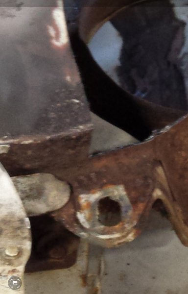

Original 67 car. Plant unknown. (To.me at least.)
How about here?
There is very little adjustment at the rad support. The fenders bolt down the rad support sides and the holes are elongated horizontally only, and the nuts are welded to the fenders, so there is no height adjustment at the front. You may be able to squeeze a shim in there but why bother, just adjust the hood bumper !!

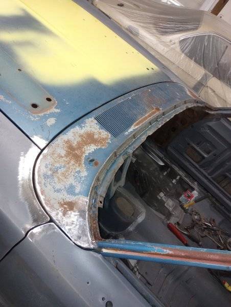

there is a stud on the under side of fender, just forward of the upper door hinge.......... you're gonna want to slide U shaped shim in there to lift the fender a bit if needed. then another one on the short stud sticking up out of the cowl. they are critical for proper alignment to the cowl, hood, and door......
I have found the round ones at the bottom of the fender, probably so they can't fall out
tip: I leave the long stud under the top of the fender out until after the fender is in place......it's just easier
