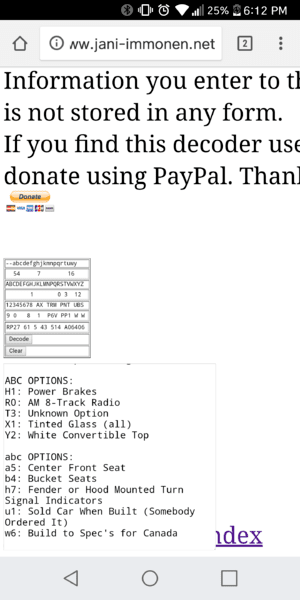

Hey I was just decoding my 68 sport satellite to see when it's 50th birthday is and on the decoder it says ABC options t3 unknown option. Any ideas what the option could be? May 14th is the 50th birthday btw.. Gonna have to treat her good that day!

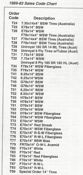

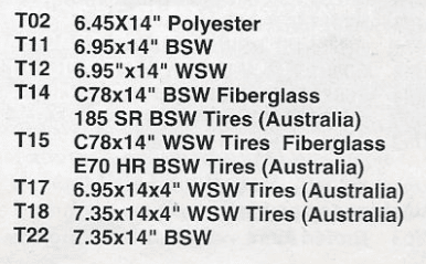

Can you triple verify T3 is what's on your fender tag? T codes are tires.....here's from the Chrysler Car Enthusiast post...
573 steering wheel - premium woodgrain

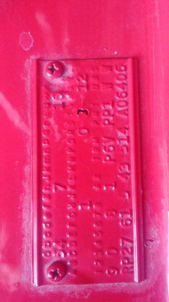

Here's a picture of my tag, I'm just going by what the decoder says. 68 is so much different than 69!
Is the 3 an inspection stamp? I wondered why it was punched through!
Yes. That’s just how StL plant did it. Every plant was different. Some are through, some are raised, some are on another strip of metal.
Well there's my frickin problem! Thanks so much! No more confusion!
