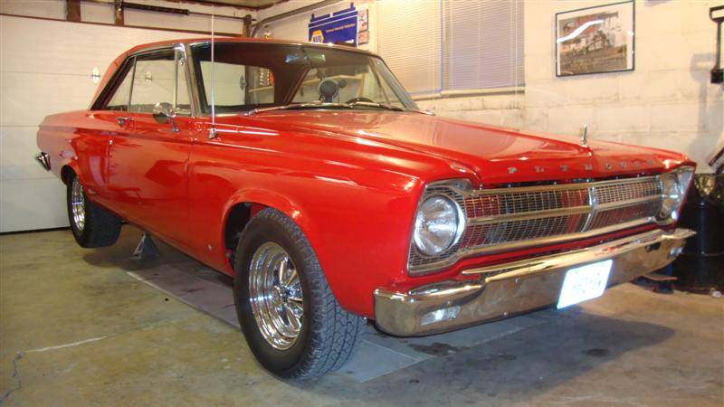

FBBO Member "Todd" posted this pic of his Dads car in the 65 picture thread. Want to go the same route.

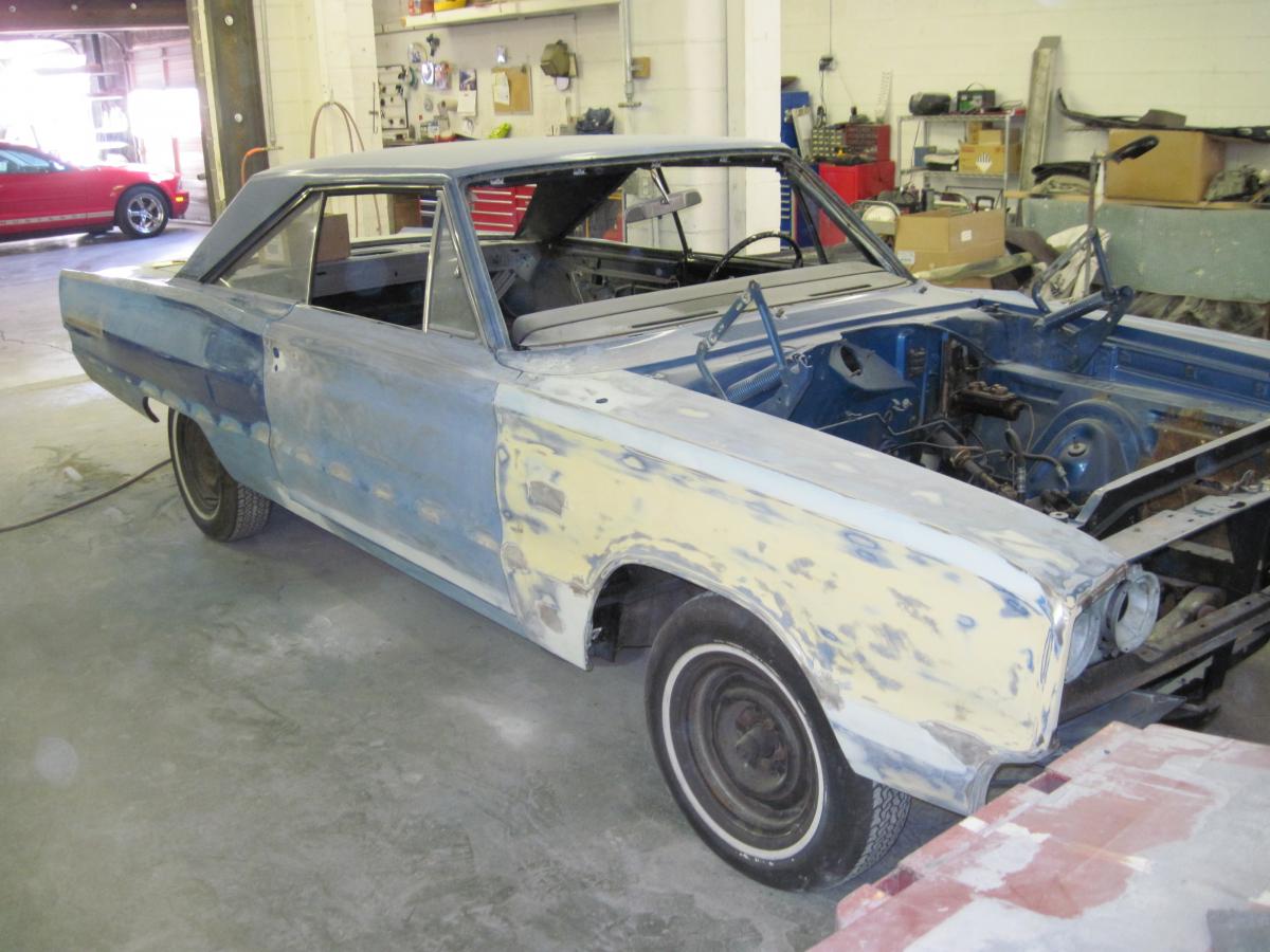

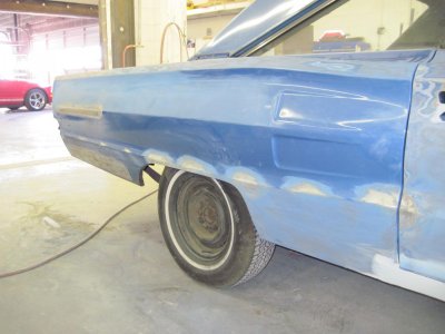

I'm sure I'm not the only one to think of it, I first used that method when filling many trim holes on the body of a 78 ford pickup I did for myself in the mid 90's.
Used it many times since on other projects with good results.
