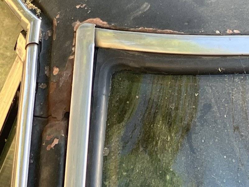

The Coronet had rust in the cowl panel before it was painted. The shop made repairs but missed something that may have not seemed important to them at the time. The cowl is the bottom barrier of the gasket and glass. It stands to reason that for the glass and rubber to fit and seal right, you’d need some means to keep them from slipping down toward the hood.

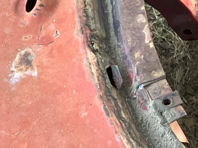

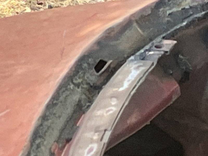

This red cowl came from a 1966 Satellite parts car:
I saved the fender aprons, core support and frame rails to use if I ever crunch my cars enough to need replacement!

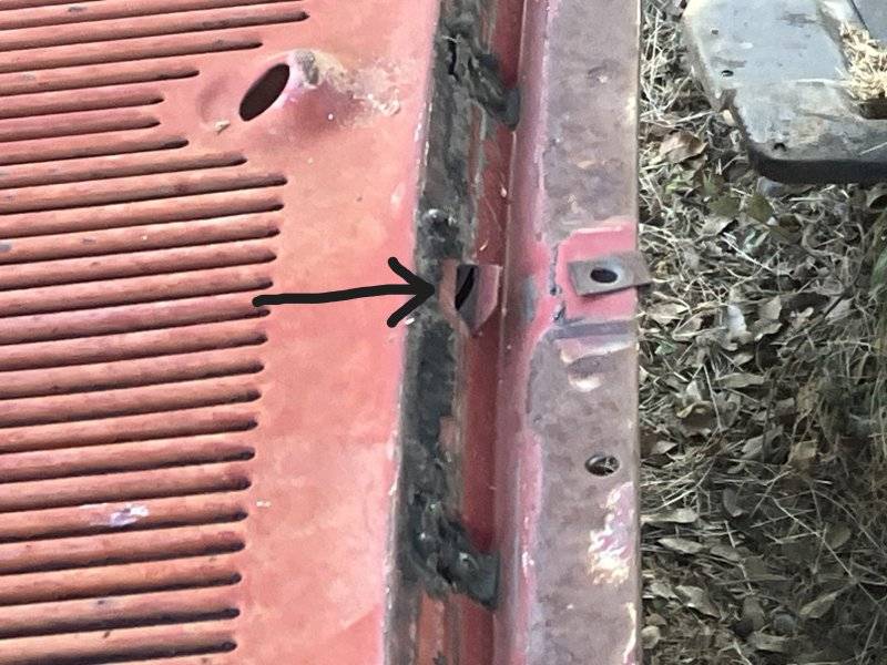

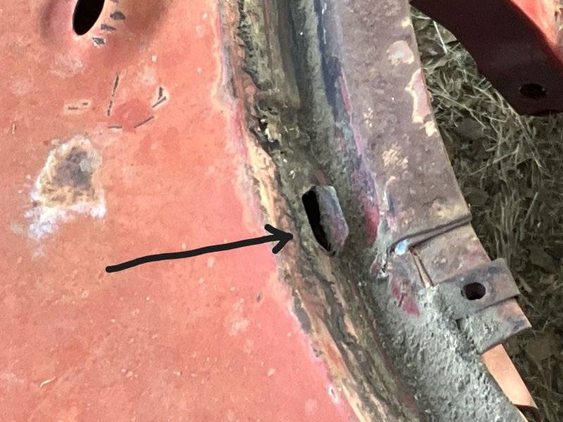

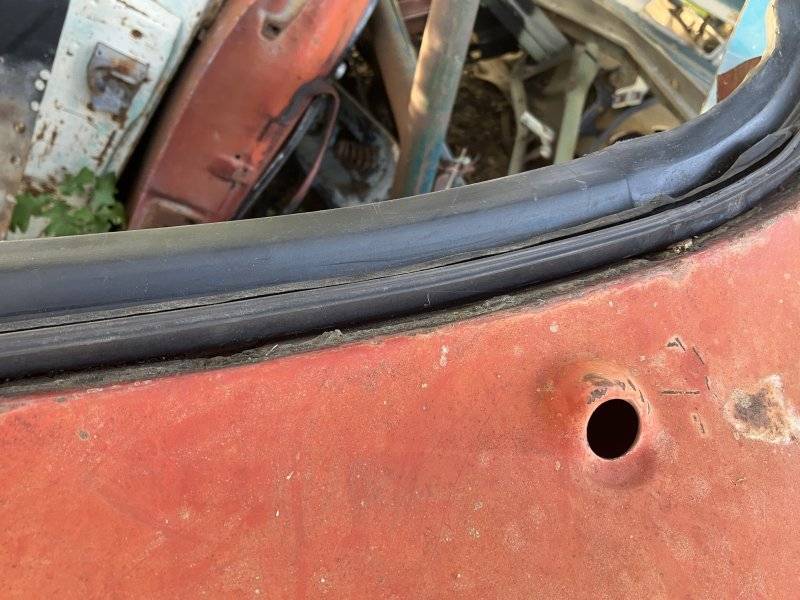

Lookie at the “fence/channel”…
You can see evidence of where there was some type of sealant.
@CoronetDarter

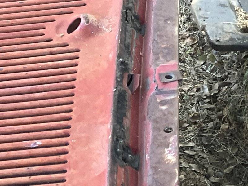

Now look closer. It appears that the factory stamped the cowl panels and punched three holes and left a tab there to serve as a “stop” for the gasket/glass.

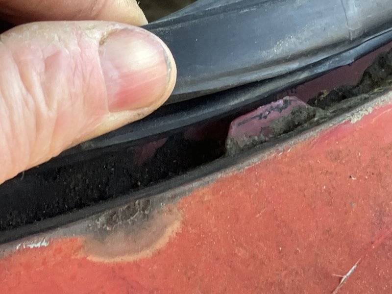

You can see a groove in the back side of the gasket.
It definitely keeps the gasket from slipping.
This Coronet didn’t have these tabs. I didn’t know what effect it might have on installation since the windshield did lay flat and nice before we went to work on it.

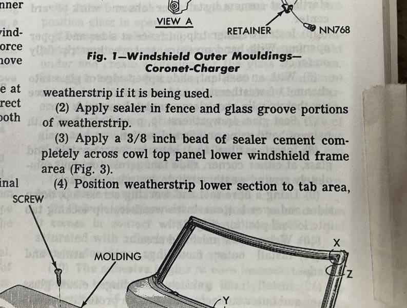

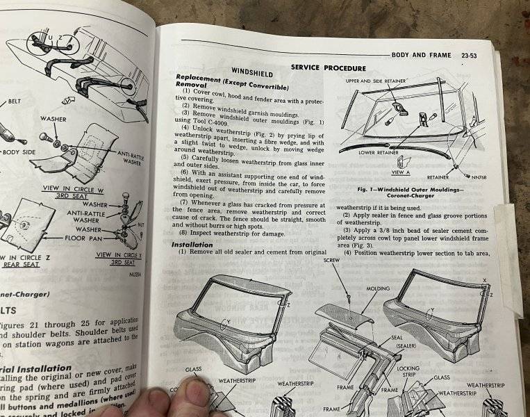

Following the instructions in the factory service manuals….
The text of both were either identical or almost so.
Here is where it gets a bit stranger…
Read #s 2 and 3. Apply sealer in fence and glass groove portions of weatherstrip….apply sealer on cowl panel.
We did that. In fact, we had that great non hardening sealant you may have heard of…
For the record, Rich said he had no leaks before but admitted to not driving the car out in the rain. His car had no sealant in the gasket or anywhere in the metal frame of the opening.
Even with no tabs in the cowl, everything other than the torn corner fit and looked as good as any original car I’ve seen.
We thought that following the FSM would be smart but I think in this case, it made things worse. The sealant in the grooves made the glass not sit into the grooves deep enough, in a way making the outer dimensions of the glass and gasket seem larger (or the window opening smaller). The lower corners here…
…want to push and twist/roll the gasket out of position.
The FSM has a weird procedure…
See #6. Slide UPPER edge of glass in weatherstrip??
Yeah. Install from the top and work down. We tried that. It pushed the gasket out….probably because the cowl didn’t have the tabs in place but was that the only reason?

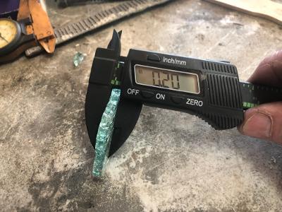

I measured the glass from Rich's car, it was .26". A spare new PPG windshield of mine....
....Measures .24".
A few years back when I broke my rear window, the new AMD replacement was also thinner.
For the rear window, it makes almost no difference since the glass sits on the butyl tape. With these windshields, they fit in a groove so the thinner they are, the looser the fit.

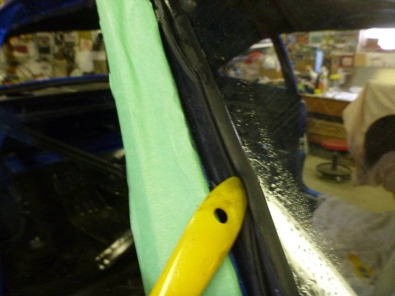

Today the man installed the glass without sealant but with Linseed oil.
Linseed oil - Wikipedia
This allowed the glass to glide right into place, the gasket flanges were easy to slip around the glass easily. Rich and I used spray glass cleaner and later water with detergent mixed in. For me, it sucked because it seemed to dry too fast, increasing the risk of tearing the flanges.
The man worked from the bottom UP which makes more sense to me than the factory method of going from the top DOWN.
I wonder how the assembly line workers were able to install windshields on the assembly line in a timely manner.

The installer today thought the glass was a tight fit, as if it were cut a little wider than it should be. The height seemed fine to him but the flaps on the A pillars were harder to fold over.

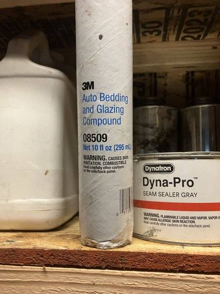

Sealant is necessary. Use lots on the bottom corners at the transition from cowl to A pillar. You found 8509??
As of a year or two ago there is NO comparable product.
I'm going over my emails with CL Lawrence and my testing of 777 and 7708 to refresh. (They weren't a lot of help and talked out of both sides of their mouth about it.)
777 "hardens" and 7708 remains tacky. I've used 7708 addition in the channel to assure non leaking covered with PTF tape prior to reveal molding installation.
Last I checked Steele Rubber listed 7708 which would work I guess. But again, it is NOT the same as 8509.
