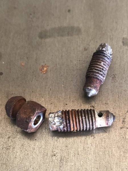

Both bleeder valves on the rear wheel cylinders snaked right off, any hopes of honing in place went right out the window.. These wheel cylinders looked fairly new, still shiney under the break dust. Maybe 10/15 years old? In contrast the US made original front wheel cylinders, 60 years old (with prob 100x the miles on them) came apart nice and without any parts breaking!
Watch out for the newer Chineseium, I guess

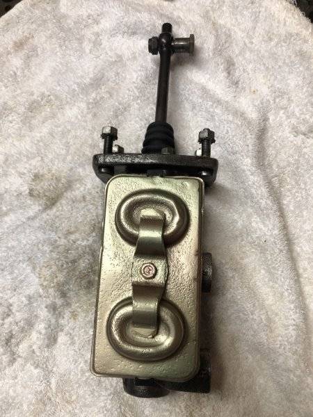

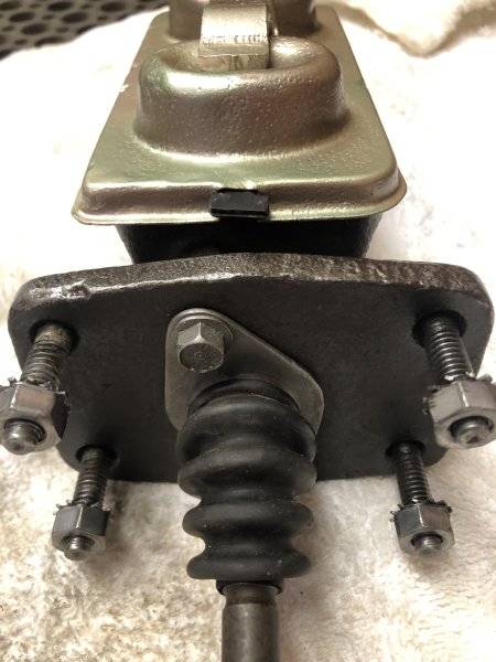

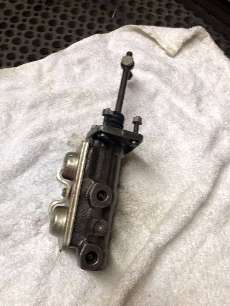

Shame on me, no before photos, this double hump 2660809 was rough looking with surface rust and a beat up top
Rebuild Bendix 2660809
- Wire wheeled outside as best I could
- Honed the bore
- Clear coat outside
- Install
Raybestos Dorman rebuild kit (Dorman - First Stop MAS TM59051 Brake Master Cylinder Repair Kit)
- - Residual pressure valves were missing before rebuild… installed new ones that came with rebuild kit, correct for drum brakes
- Installed new valve seats, tapped/pressed in with a socket.
- Install cylinder retainer off an old single MC.
- Repaint the top to look like Golden CAD with Tamiya paints, Titanium gold, then dust with Transparent seed and Transparent Green
Turned out good I think
