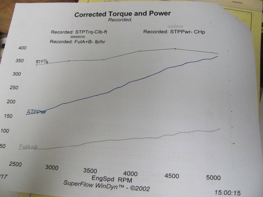

Here is the HP/TQ graph of the very first dyno pull on the 340. 2,500-5,000 rpm. The printer ran out of ink and I had to darken the lines by hand. We only did three pulls all together. After the third pull went 400/400, we said, "That is good enough!"
