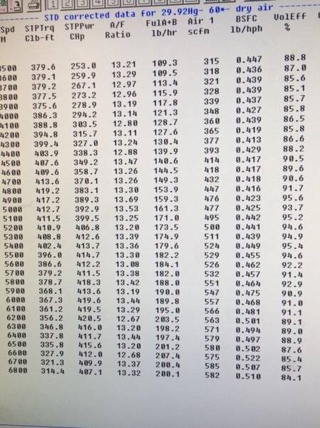

Dyno sheet critique.......
Imo, the dyno carb isn’t all that dialed in(at least not for that combo).
Big lean hole in the middle.
Builds like that rarely respond favorably to a/f ratios in the 15’s.
Fuel flow between front/rear isn’t balanced that well.
Up towards the top of the pull the a/f ratio is getting more normal, so it’s doubtful a different carb would have yielded drastically different power.
Checking the uncorrected power from the fuel flow and bsfc numbers....... the uncorrected power was actually higher than the corrected power.

At 5400, 94.5 + 88.5/.404 = 452.9hp uncorrected.
Cool! Guess the air was pretty good!

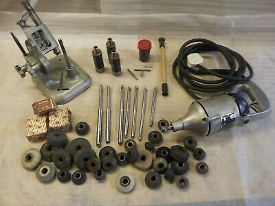

How do I get in the peanut gallery?
Guess my 50 year old B&D vibro centric, had already got me there lol...:rofl:

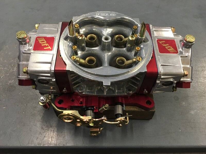

A few years ago I had the idea of testing just what kind of power differences there were by swapping out a stock 750DP main body for one of the HP bodies.
So I bought one(I had previously built several new carbs out of the Proform bodies with good results, but never compared to the stock body).
Then I thought....... maybe I could test some billet metering blocks too.
When I got done buying parts....... I basically had everything to put another carb together.
So...... that’s what ended up happening.
Never did the test. In fact I’ve still yet to try this carb on anything.
It cost as much(or more) to build it as to just buy a new Brawler 750 now.

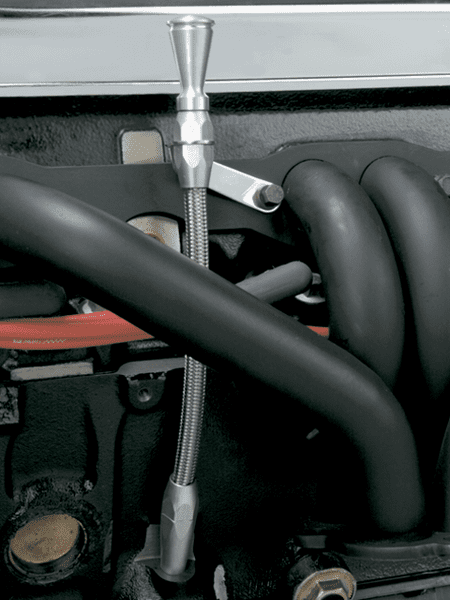

You mentioned snapping off the dipstick. After building my 440 and using Doug's headers I couldn't get the stock dipstick tube to seat properly and it wept oil at the base. Wound up installing a Lokar flexible dipstick. Its a nice product with O-rings at the base and secures on top to one of the exhaust bolts. No leaks since.
I'd like to use the Lokar piece and it might even be a necessity with some combinations. However, we used a specific length dipstick to work with the larger capacity 440 Source 6 quart pan. Like you mentioned, the Lokar is a completely different design with o-rings so I don't think we'd be able to use the flex tube with the existing OE-style stick.
The dipstick is turning out to be kind of a PITA actually to the point of considering a block off plug. Generally, you put 6 quarts in and unless there is a severe leak there should be 6 quarts in the pan when it's time to change the oil. Even if there are drips you're not likely to be a quart low just not sure I trust my friend with that situation. We'll probably just order a new tube. Believe we just need to grind down the block end more before putting it in. Also probably best to wait to install it until the headers are on.

Have you ever tried playing with the emulsion jets on the dyno?
..surprised you haven't tried your creation yet..
I haven’t messed with the E jets on the dyno.
I can see where that could really eat up some time though.
As for the new carb....... I just haven’t needed it for anything yet....... and since it’s untried at this point, it’s not quite ready for use as a dyno mule.
If the right build comes along, and time permitting....... I’ll try it at some point.
I’d prefer to try it out on something like a SB with a fairly rowdy cam making around 500hp.
