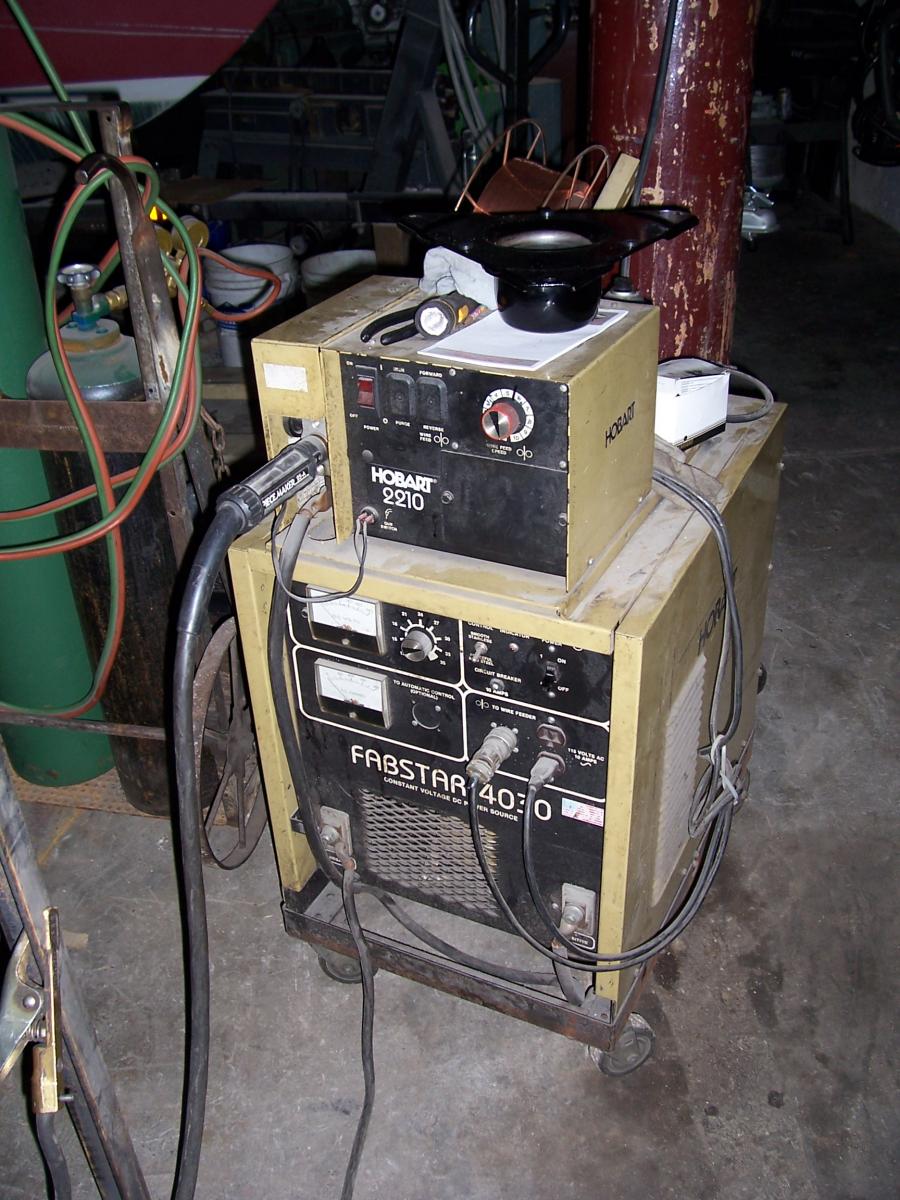

Now for my next task, I was going to try and wire up my welder but it has 4 wires on the plug, I was told that means that it is 3 phase. I have no idea how to wire it up. I looked on google and I read somewhere that each phase has to be hooked up in a certain order.
Can I just run a hot wire off of three different breakers, or is it more complicated then that?
Again, thanks for all of the input.
Double-check the data-plate on your welder. Unless it came out of a factory, it should say single-phase, or 1-phase on the plate. Some newer units can have 4 wires. 2 for the 240 volt power, 1 neutral [for any 120 volt components], and 1 ground. Let me know what you have. Scott
The welder did not come out of a factory but it is a hoss of a welder and is 3 phase, on the data plate it reads 3 phase with line in volts being 230/460/575. It's an old Hobart Fabstar 4030 model. It was the welder at my old work that ended up closing its doors, I got it for next to nothing, and it's an excellent welder.
The bad news is that you CANT hook it up without using a 3 phase converter. And they can be pricey! A few hundred dollars at least! You might think about Craigslisting your unit, and use the money to buy a 240v, single phase unit. That one looks a little big for home and hot rod use anyways. Unless you do heavy welding on the side, a machine that handles up to 1/4" is the most you need as a hot rodder. The larger machines have trouble "dialing-in" for the thinner metals we use on most cars.
