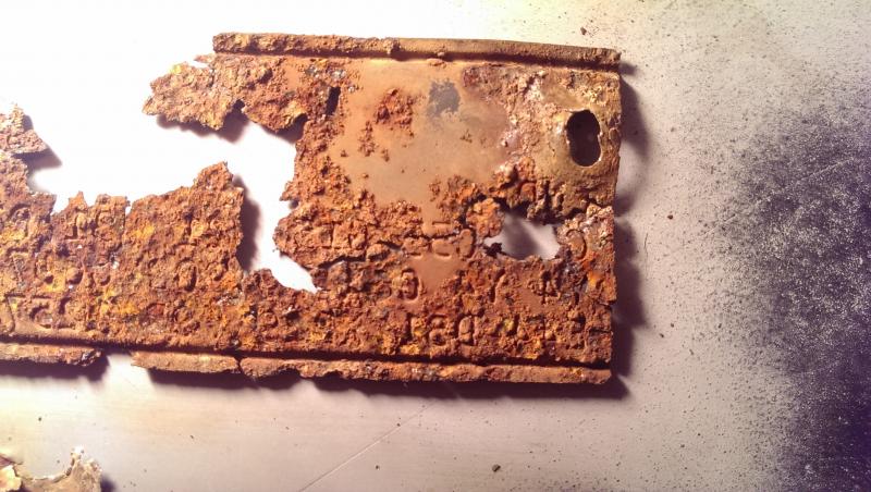

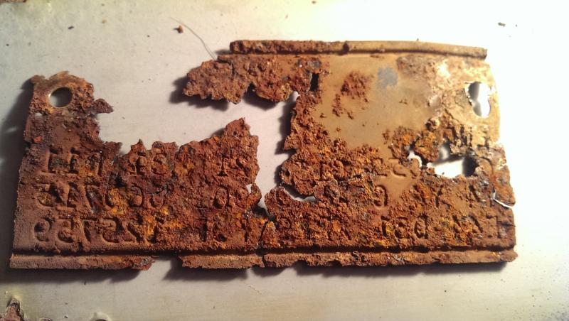

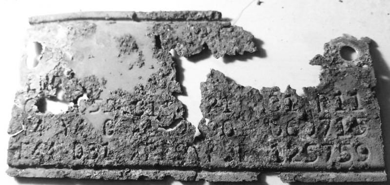

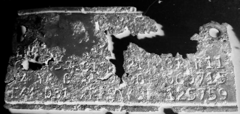

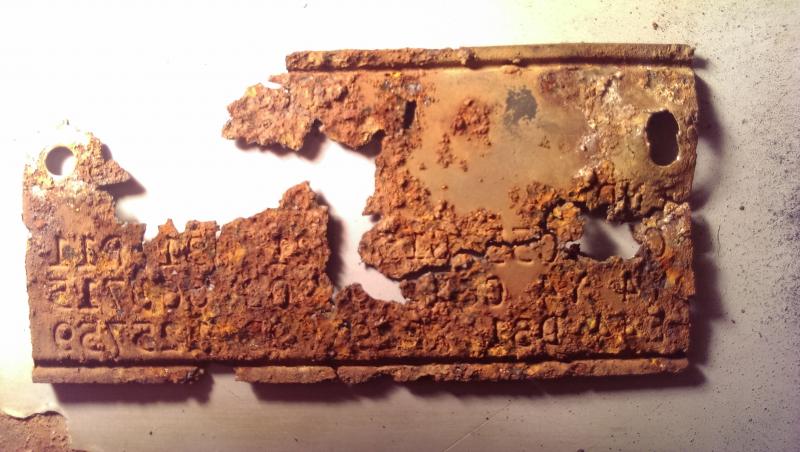

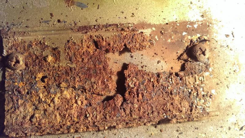

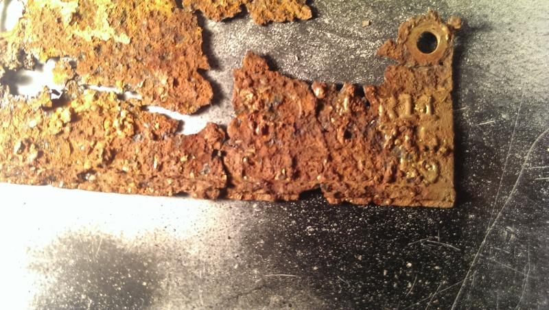

hopefully these will suffice. picked out what ones seemed to be the clearest. I can make out an R11, 715, Y4, C55, 21, and the 25759 from the VIN.
Bottom line: E44, D31, XP29 F9B 125759
Next line: Y4 Y4 C6? (You said the interior had some black. If yes, then C6X is likely. Possibly C5X) ?? (If interior is black then X9) 902(? on the 2. Could be a 1 SPD) 0(?)60(?)713 (VON number)
Next Line: C16 or C21 (Unknown. Does the car have a buddy seat or console?) C55, G15, M21, M31, R11
END
Console. Is there a book or something that has a breakdown of all the codes? I'm new to the whole resto process and grew up in a Chevy family.

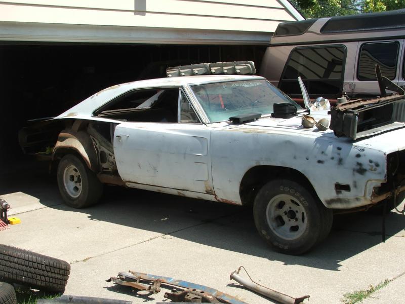

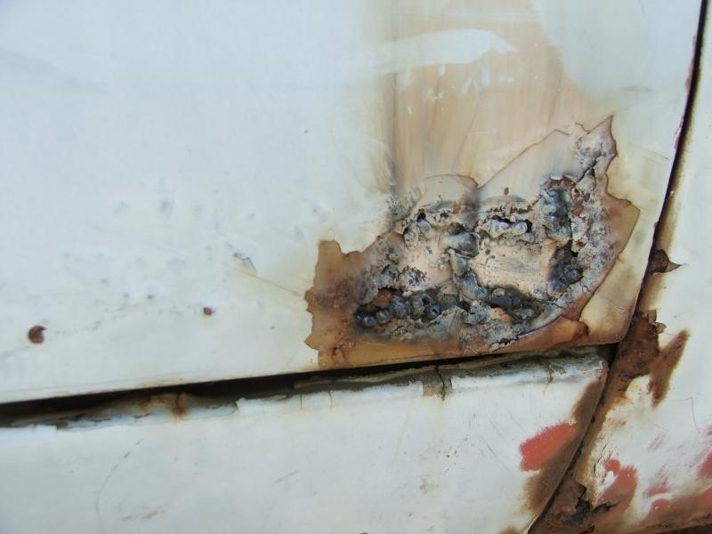

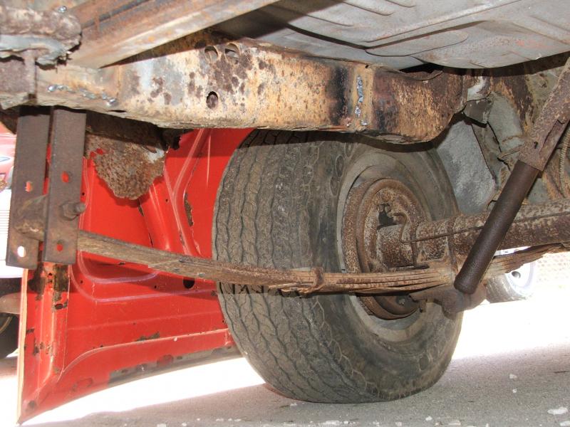

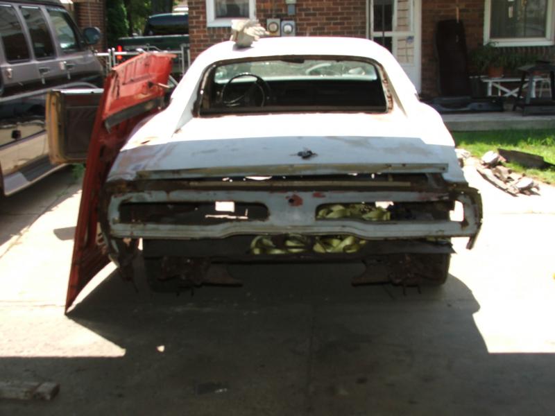

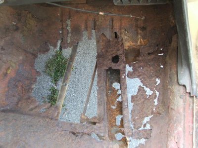

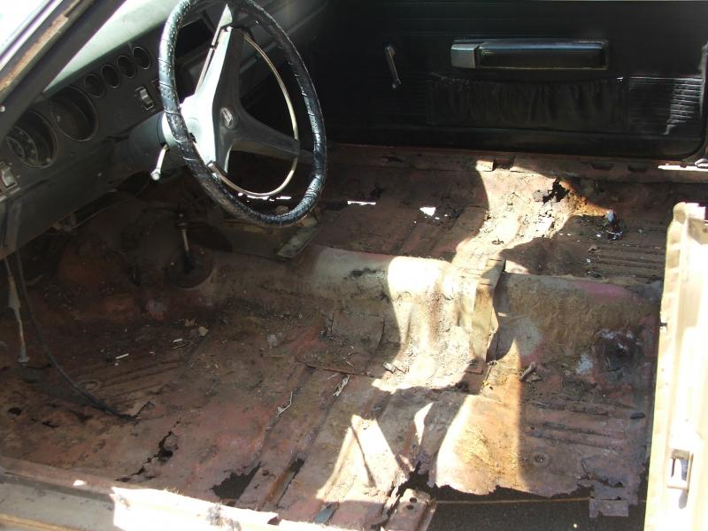

Yikes, that one is bad. How is the rest of the car? We might have a resto rivaling Don's coming up lol.

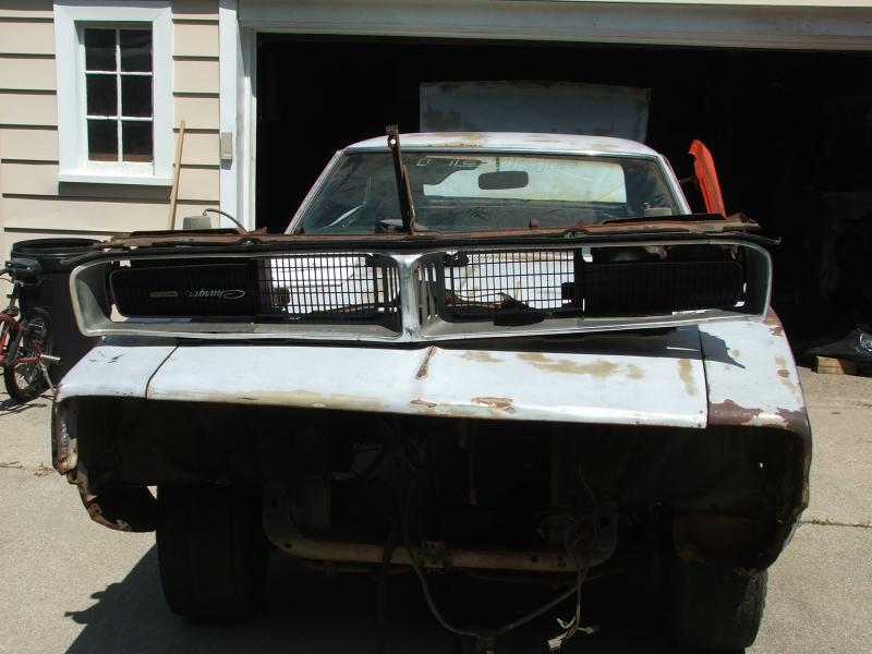

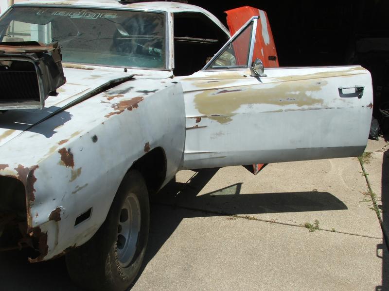

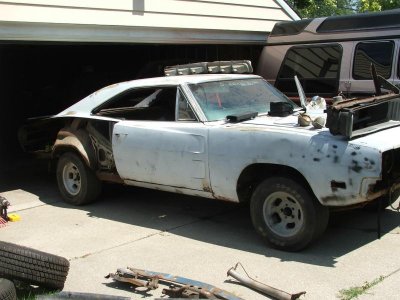

Rest of the car is just as bad haha. Pretty much everything but the drivers door and roof need to be replaced. Both front frame rails are rusted through, back ones look like they had been cut in half and welded back together, sail panel and deck filler are rusting out, trunk floor and passenger side quarter panel are gone.... got the car with a big block trans and 70 bucket seats.... I'll post up some pics of the car.
That's what we call rough where I come from and most from other places would call all of the cars here rough so use that as a gauge :)
Oh yeah, she needs a little more than a hug. I've always wanted a 69 Charger though and felt that she needed to be saved. At this point my plan is to basically make an R/T clone since the car seems to be as plain jane as you could've gotten. Bought a 1970 440 6 pack with '64 Max Wedge heads that I'm going to rebuild and slap in it. I know I could've bought one already restored for what I'm going to put into it, but where's the fun in that? lol.
