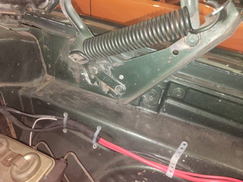

From my unrestored 67 GTX. Lower left corner of picture.
Thanks. The bolt and strap look to have been natural. Can you tell if the lid was natural or yellow zinc dichromate?. Maybe even silver zinc ? I wish I still had my 67 GTX. It was bronze with a black vinyl roof.
Lid is yellow zinc dichromate
Strap is natural steel.
Bolt is black phosphate
