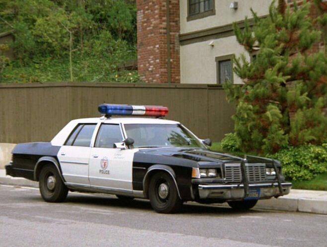

I think the R body had the 11.75 with slider adapters. Or maybe the police versions. Not many police versions, but I remember seeing them in the junkyards back in the day.
Old picture I found on web:
Yes, the St. Regis came with the slider type and 11.75" disc, as well as other models:
