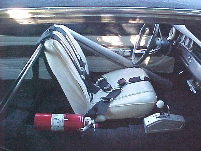

I fabricated a bracket and welded it to the floor, it's directly underneath my right hand, and I don't need to look at it
to pop the latch, grab the extinguisher and exit the vehicle. The mounting holes I needed were drilled in the bracket instead of the floor.

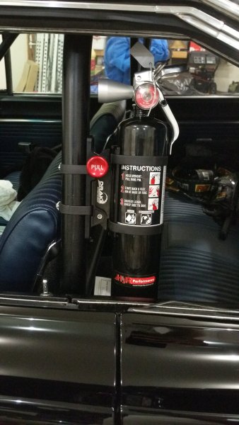

I have mine mounted on my rollbar so I can get it quickly, or someone outside the car can retrieve it. Super easy release mechanism, and it looks good to boot.
