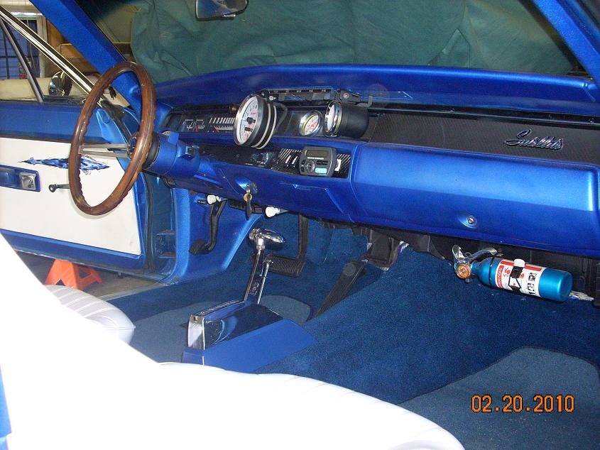

Couldn't get a good angle, but here is a pic of mine. The mounting bracket keeps it from rolling around. Like I said, you could probably make a simple bracket attached to the seat rail and mount the bottle bracket to it.
I get it now...duh The way I drive it won't stay there, I need to make a bracket, need to look in the back seat too.

You can see mine in my 68 on the right side by the heater box.
