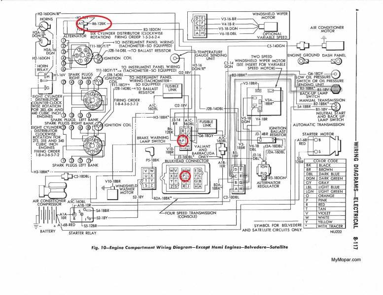

I don't have any schematic unfortunately but curious what wire is the main hot wire that comes through firewall bulkhead on my 69 gtx and goes directly to the amp gauge on dash. Thanks
The biggest one !!! It will be a 12 gauge black wire going through the middle connector.
"P" in the photo below
