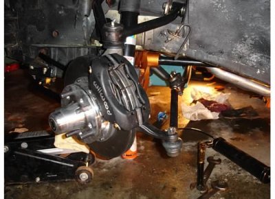

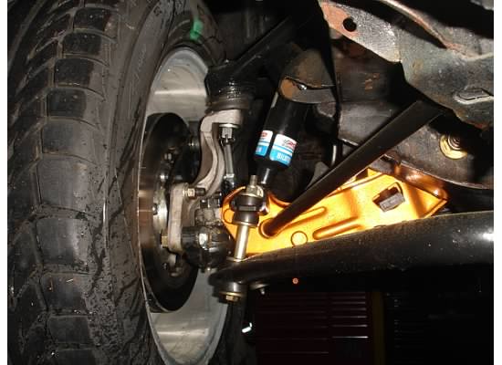

I have not upgraded to the FFI box but a I have almost everything else. I even did the Moparts power steering shim. It all feels pretty tight and I am pleased with the results... disc brake.jpgsway bar.jpg
