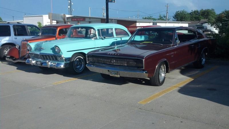

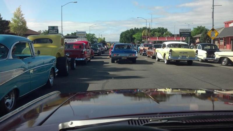

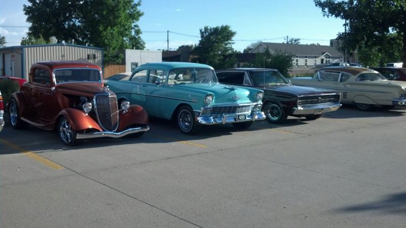

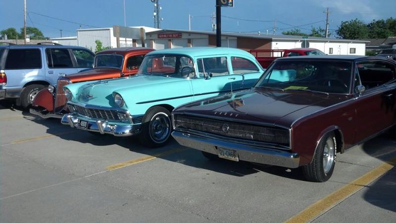

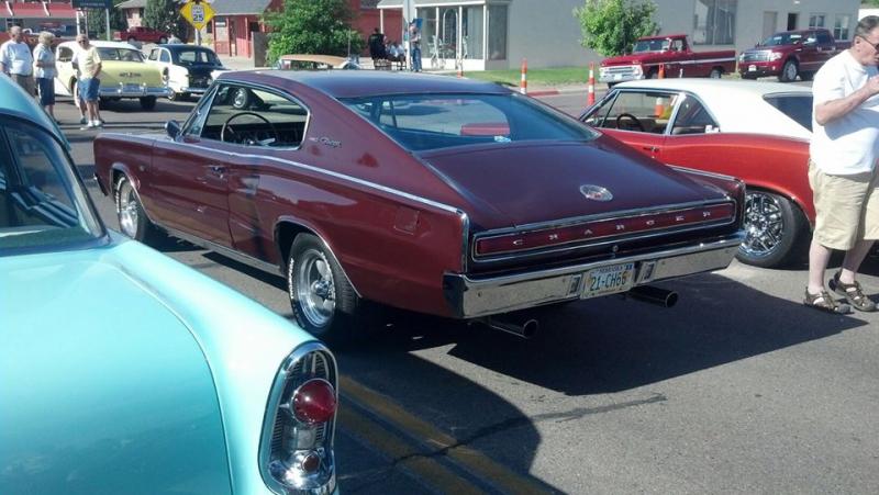

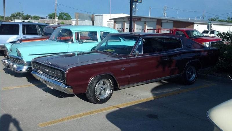

Just went to my first big car show this last weekend, didnt win anything but enjoyed the time i got to spend talking about my car.
It was kinda cool there where two groups of people who looked at it, the one who used to own one at some point in their lives ( which was alot more then i imagined) and the ones that kinda glimpsed at the car looked at the interior and then there eyes lighted up.
Also Talked to a guy who was from Germany who visiting and wanted to buy a muscle car and take it back to Germany. He wanted a mustang, but was very impressed looking at my 66 charger (think i got him to maybe rethink the mustang thing).
Got warm welcomes from the very small group of mopar guys that where there maybe 10 out of the 350 cars.
Once again i was reminded how proud i am to own a 1966 dodge charger
Here are few crappy pictures from registration night and the parade
