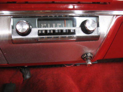

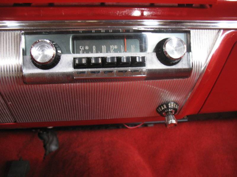

Got it installed and can not get it to work.
Power to the switch and no farther.
red wire to the switch and then to the radio, no power to the radio.
Went back to the just AM and works fine.

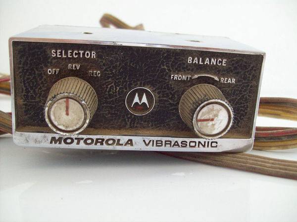

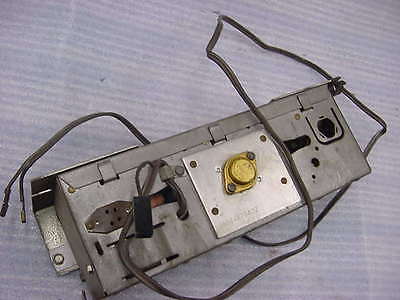

I had the Motorola Reverberation unit (Vibrasonic) in my first Road Runner. If I remember correctly, I mounted it in the trunk. Might have been under the rear package tray.
This was the under dash control unit.
I think this was the trunk unit.
