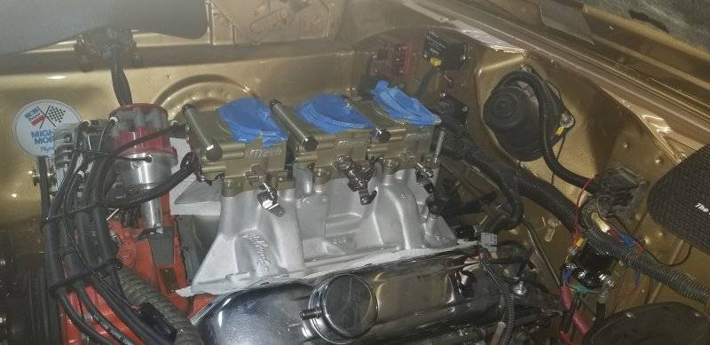

Just curious as to what kind of issues your friend is having? We just got the FiTech Six Pack set up and we are getting ready to do the install. It would be good for those who are thinking about this set up to know what we should look for..

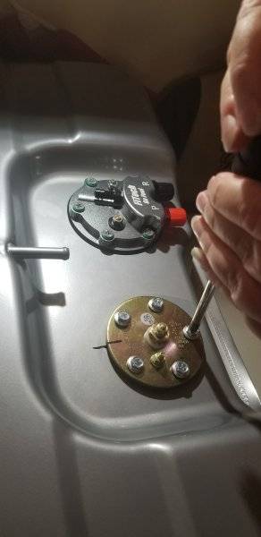

BTW, we got the tank from Summit Racing.
(EDIT) I forgot to add that our conversion is for a '69 Belvedere.
One of the issues on the Fitech forum is getting IAC, idle air control, set correctly. These are not like carburetors that are progressive. They all come on together as the injectors are batch fired. So even if the throttle body on one isn't open, the injectors are sending fuel. The key is to spend time adjusting the linkage between all 3 to operate at the same time. Then, adjusting one throttle body IAC can adjust all at once.
Looks nice,
