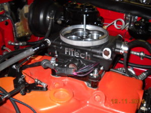

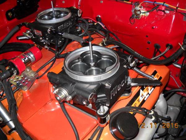

Nice units, and they’ve been around long enough where all the bugs are worked out. there is some good threads on it here. Got the 1200 unit for my ride
