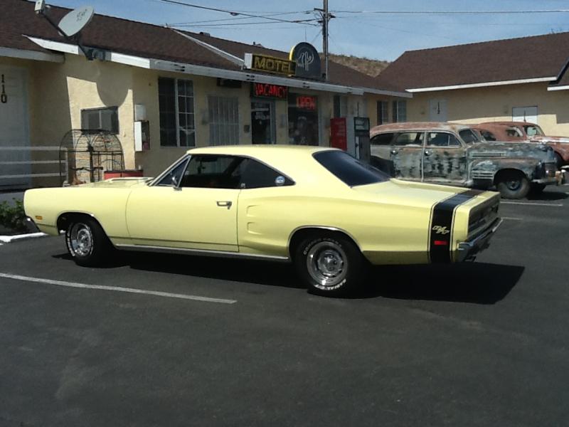

Just like the title says, here's a little post I made about my new tires and wheels.
Getting a little rub on more aggressive left hand turns, not anything too crazy, but pretty consistent rub. Cant tell yet where on the tire it's rubbing, and I want it to stop.
Thinking about new rear leafs, Its already up on shackles (only one hole up) but i'd love for it to be on springs only, and have a nice stiff ride in the back, and no rubbing anywhere if I do ever want to carry 5 people in the car. It might happen. I plan to drive this thing around town, and maybe take it to the strip once in a blue moon.
Loving the look of the wheels, and the badass-ness of having four new tires. Haven't been able to take it up to freeway speeds. It used to vibrate at around 70, I'm hoping the fresh wheel balance helps.

iPadJune30,2013 164.jpg 295/50 15's on 15x8 Rallyes. 69 Coronet. Lots of room. Could have gone 305's. Coopers. 68 to 69 wheelhouses that much different or is it the 8 inch rims? We put them on my friends 68 Barracuda and they barely rubbed on the outside on turns.
