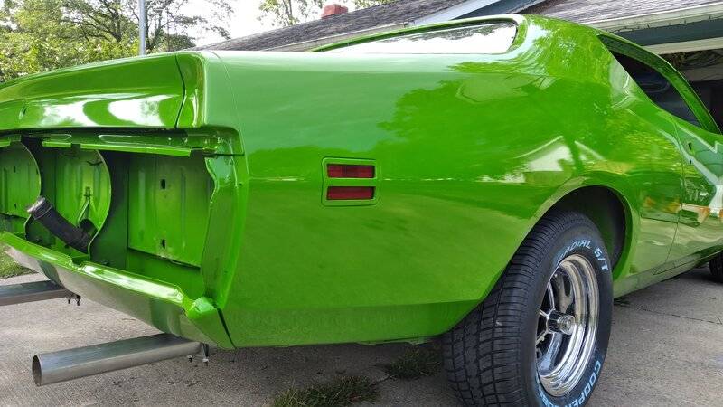

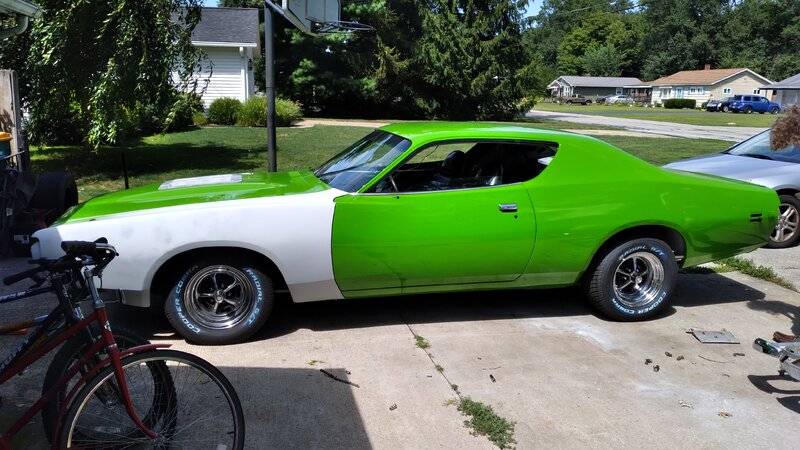

I used PPG DCC FJ6 Green Go in single stage on my 71. I used Akzo Nobel BC/CC in FJ5 about 15yrs ago on a 70 Dart. I like sprayjng the single stage way better. I sprayed bc/cc for years proffessionally. Good thing about single stage is you can sand it smooth and clear coat it as well. And if you have to spot or something to repair it's easy to blend and buff. A fellow friend and body man did that on a 73 Runner and on top of his magical bodywork the paint looks 5ft deep after doing that. My plan is to do that eventually but, I'm liking it so far. Lay it down how you want it to look and it buffs good also. A little messy but a lot of fun things are! I like cuttin n rubbin myself so doesnt borher me. Still need to buff this...
As advised I'd buy it all at once, but I myself bought a quart and cut in the engine bay and trunk. Bought a gallon and used on the rest on the car, that color kind of bounces off each other and you can't really tell the difference. I'm a painter and I have to look really hard to notice and sometimes can't. Being a solid color I'm using the same gallon and I painted everything piece at a time at different times. Can't do that with a metallic

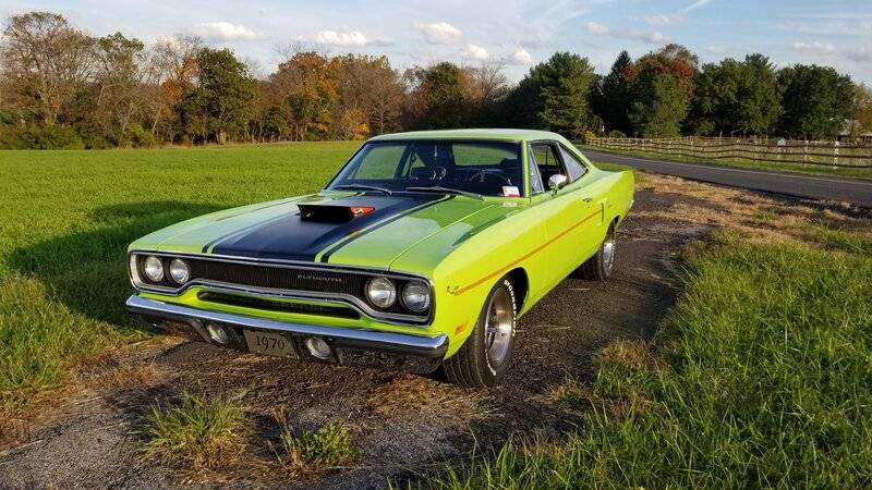

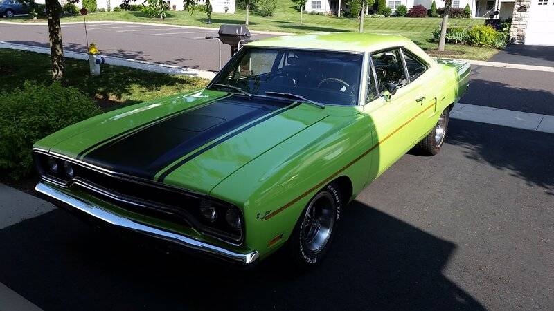

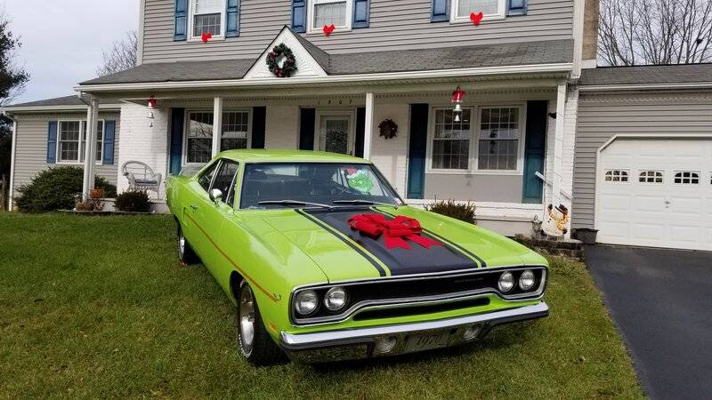

As I'm sure you know, looking at pictures can be deceiving. Here is my car in various light and I think the paint can look very different.
Here is one in mixed light:
Here is one in full sunlight:
Here is one on a cloudy day (my Christmas display!):
