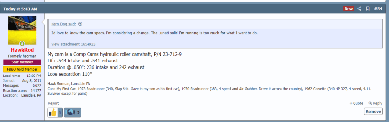

I'd want quieter operation, more vacuum for the power brakes, a power peak below 6200 rpms and more power than the '528 provided. FBBO Moderator @HawkRod has a hydraulic roller in his Road Runner and is quite happy with it.

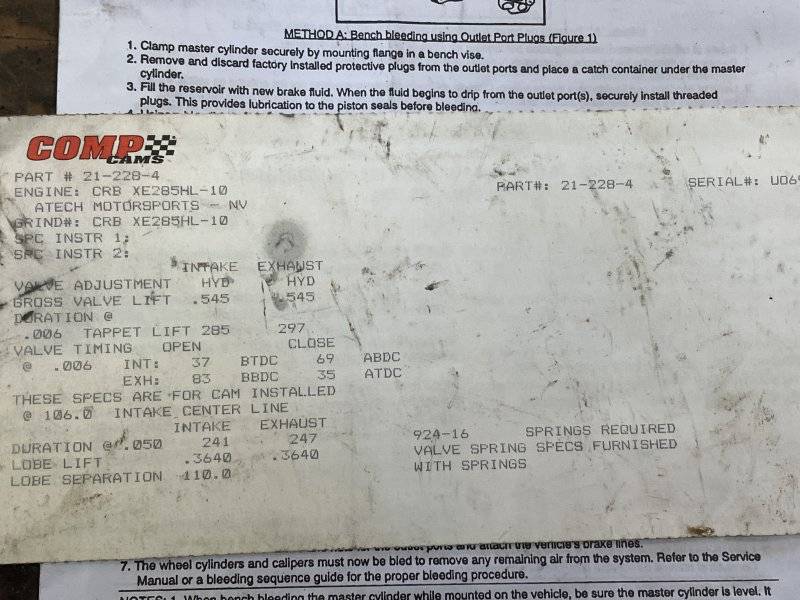

How does one determine the overlap that a camshaft will have?
The first set of specs here is from one of the Comp Cams XE285HL that I had in 2006:

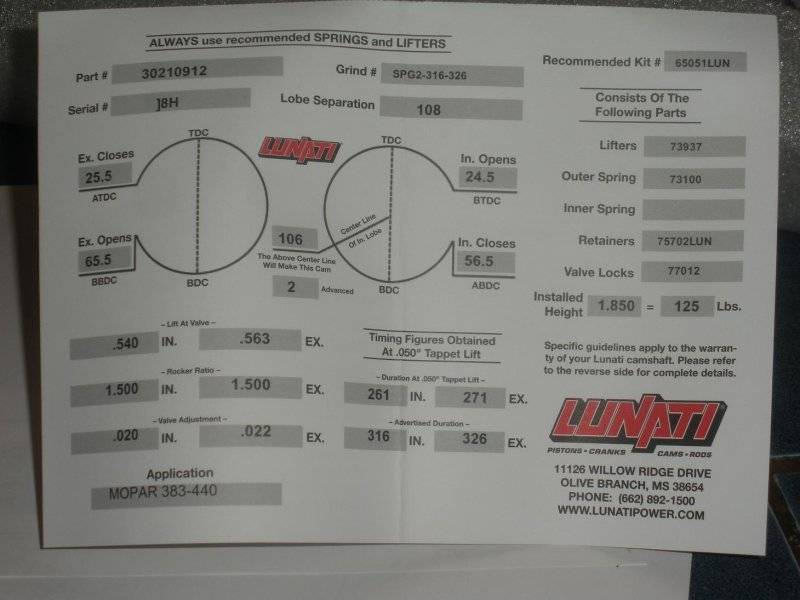

Here are the specs for the Lunati that I have in the engine now.
To calculate overlap, you add the exh closing to the intake opening. For the Comp 35+37= 72*.
That makes sense and I did notice that but why the heck did Lunati list their numbers above? This cam I'm running has to have more than 50 degrees of overlap for how rowdy it idles. What did they do wrong?
the lunati cam has 100 degrees over lap using intake-exhaust. I get 71 for comp and 105 for lunati using advertise duration and LSA specs. must have to double the intake and exhaust valve opening and closing specs for the lunati

I was getting 71 for the Comp, using the adv duration and the lsa, which doesn’t agree with the open/close numbers(72).
Then I saw that the open close numbers are 1 deg off on int(286) and ex(298) from the adv duration numbers.
The Lunati is 105 based on the advertised(which is at some undisclosed lift point), and lsa.
Overlap numbers are usually based of advertised duration.
Keep in mind that comparing overlap between solid lifter and hydraulic lifter cams isn’t going to always be “apples to apples” because of the varying lash points of the solid cams vs the zero lash of the hydraulics.
The same holds true for solid cams that use different lash points and/or advertised duration lift points(the lift at which the adv duration numbers are measured).
the modern solid cams with a tighter lash like 16-18 thousand you can get close with taking 6 degrees off the duration at .050 so 226 hyd would be 220 at .050 on a solid cam. you need to add about 12 degrees to the advertised duration on a solid cam. so a 268 hyd would be close to a 280 advertised duration on a solid.
