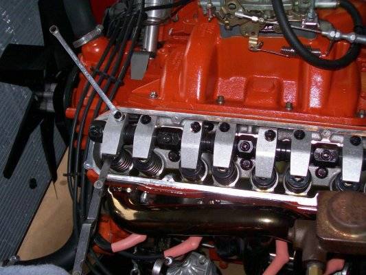

Same here as I run a Porter solid flat tappet in my street/strip 493. Its been together over 9 years and still running great. As for rockers I use these Hughes roller tip rockers and they also have been in my eng over 9 years with great service. Ron
Are the hughes rockers bushing or needle bearings on the rocker shaft?
I have a set of Hughes rocker arms on my 340 and there is no bush or needle bearing. The aluminium of the rocker arm runs directly against the shaft.
