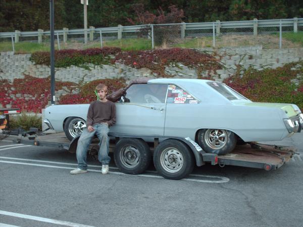

Ever see a tandem axle trailer with a tire missing? You will notice the equalizer will be banging on the frame.

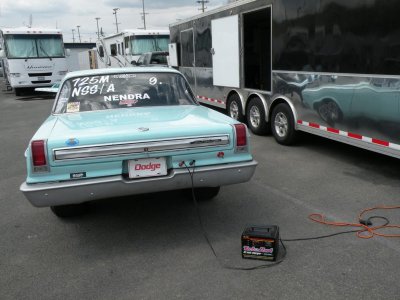

I have a triple axle trailer and I took both of the front wheels off. 1 because it ate up tires running all 6, and 2 because it was a pain in the *** to back the trailer up with all 6, and three because I never pull enough weight to require all 6 wheels. My axles are independent though, I'm not sure how well that would work on a tandem set up if that's what you have. My trailer is rated for 12k pounds with all 6 wheels. it never see's anywhere near that. And if all else fails, Most trailers are the 4 1/2 on 5 bolt pattern. I've used the wheels off of the dodge several times as temp spares. good luck.
