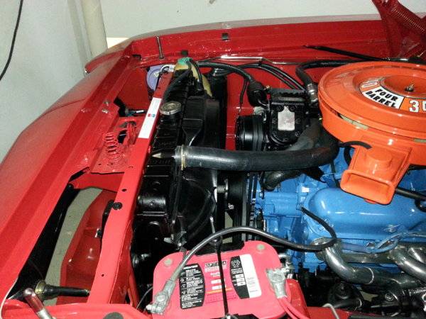

I run the dual snorkel on my 69 rr on an unsilenced base. This for clearance with the carb spacer. But the unsilenced base is smaller and therefore alllows much better breathing than the stock sealed snorkels.
