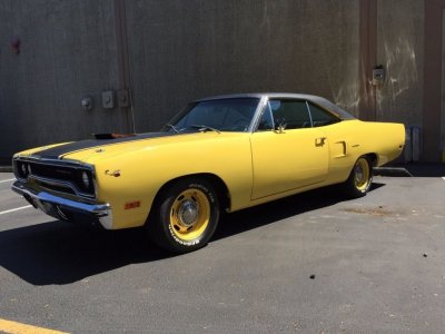

Hello everyone, long-time MOPAR fan here. I was in the position to acquire a yellow 1970 Road Runner, which I had been looking for for some time. The car is in-transit from Washington State down to Florida where I live.
It's a 1970 hardtop with a 383 rebuilt engine. The car was recently restored, and the engine rebuilt. The restoration is less than 200mi old. The restoration is mostly a factory build with the exception of the addition of power steering, air grabber hood, and engine upgrades. The engine is not numbers-matching, but is date correct. The paint code is also correct - Lemon Twist Yellow.
I bought it from a guy in Washington State, who had in turn bought it at a Mecum auction.
I had a yellow 1973 Satellite back when I was a teen, and have been itching to get another old MOPAR since.

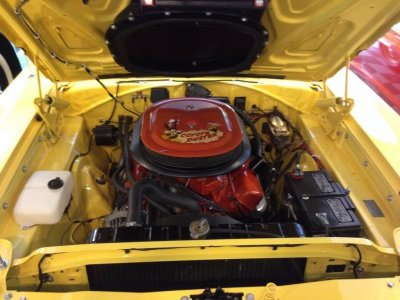

  • Correct 383 CI V-8 engine bored .030 over
  • Casting no. 2468130
  • Steel crank
  • 906 heads
  • Comp Cam with 470 degree lift, 270 degree duration
  • Holley 750 double pump carburetor
  • Ceramic coated headers
  • 727 automatic transmission
  • 2500 stall convertor
  • 3.54 Dana 60 rear end
  • Power steering
  • 15 inch Police Interceptor wheels and hubcaps
  • BF Goodrich T/A tires
  • Air Grabber hood

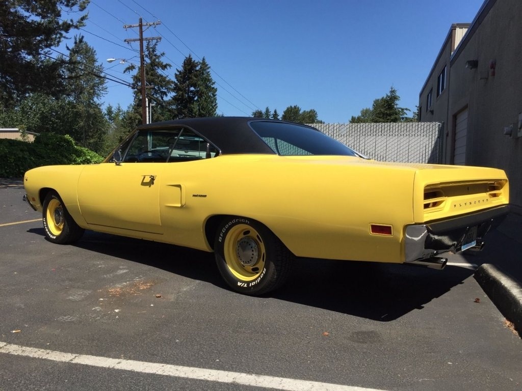

I'm not in love with the Interceptor wheels, and prefer the Rallye style. The car has its original drum brakes, non-upgraded. I see that Year One, for example, sells reproduction Rallye wheels. But, there are different bolt patterns and sizings. Is there an easy way to tell which ones would fit on this bird?
Also, what type of fuel is recommended for this engine, knowing only the above specs? How best to break in the engine? I've read completely differing theories on this, from babying it for a thousand miles, to driving it like I stole it.

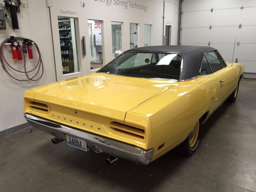

I notice also that the car seems to be missing the rear trunk-lid stripe and road runner decal. Was this a delete option? It seems the restorer was interested in keeping things stock-looking, and was wondering if this was purposeful.

Welcome to FBBO. Great looking car. It should look fantastic in the Florida sunshine.
Sweet! Welcome. Love the steelies. Tuck or replace the exhaust tips and it will be perfect.
Welcome, nice car. Only thing I can say is I would only put premium fuel in her.
Welcome to FBBO from NorCal
Yes - it's a sweet looking car. Congratulations on your purchase. Run the highest octane pump premium they have in your area. A nice set of wheels would really pop with the yellow. Like Dennis said - those tail pipes have to go. I'm partial but love the tail pipes that came on the 68.
Welcome, looks like you'll be having fun this summer. It does look a little odd without the rear stripe, but I could get used to it. I think I'd find some different wheels, also. An awful lot of yellow in that side view.
Welcome from Canada, sweet car , had a couple my self in the day. The rims you need would be 15 x 7 rallyes with a 5 on 4.5" bolt pattern,as for the rear, it would normally have the words road runner on the far right side of the trunk lid,same as on quarter panels, and a standing bird. but often with the paint treatment you have the black stripe across the back with road runner written in it,no badges ,just the bird. the right tips wood make a big difference and tucked in a bit as they said previously. I hate to be picky, but, the only other thing I see is the birds on the fenders are a little high. His feet should line up with the center of the side scoop in case you want to put on a dust trail.Love the car!:thumbsup:
Great looking Road Runner. Looks good the way it is but with the changes you want to make and what the others have suggested it'll be even sweeter.
Welcome to the site. Very nice car . What part of FL. Are you in I'm in the Melbourne area ! I have an extremely nice set of rallye wheels I might be willing to swap out for your steelys p.m. me if your interested in talking . Also if your close by there's a big cruse in we mopars of brevard put on every 3ed Thur of every month lots of cars all over the state show up we get around 200-240 at a little ol cruse in . Hope to see you out there if your near by . Good luck with that car it's extremely nice . The guy who restored it probably was lazy with the decals .I would say even though I want them those wheels would look sharp on your car if they were black instead of yellow but ether way I would be tickled to death to get to drive that r.r. have fun and don't brake it!
Your car should have 5 on 4.5 lug spacing.
I have a 1969 440 with a small cam that runs just fine on 90 octane non-ethanol.
Octane requirements have a lot to do with compression and cam timing.
We used to break in our fresh engines by driving out of town on back roads until we were about 200-250 miles out, making an effort to keep the RPMs fairly steady and not exceed about 2500 RPM.
Then at the 250-ish mark, we'd turn around, check all the fluids and gauges, etc, and hammer the hell out of it on the way home.
Great responses everyone. I really appreciate the comments.
I also noticed that the side-bird decals seemed too high. I'll probably want to do the dust trail at some point, so will need to relocate them. I'll have to research how to get a decal off without ruining the paint.
As for the exhaust tips, I see what you all mean. I'll get a reproduction set and get those on too.
Seems like a great forum. Thanks for all the advice.
Howdy from Oregon. Very nice ride, sure needs the rear stripe to let people know what just left them behind.
