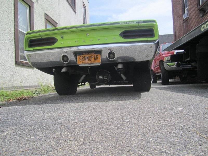

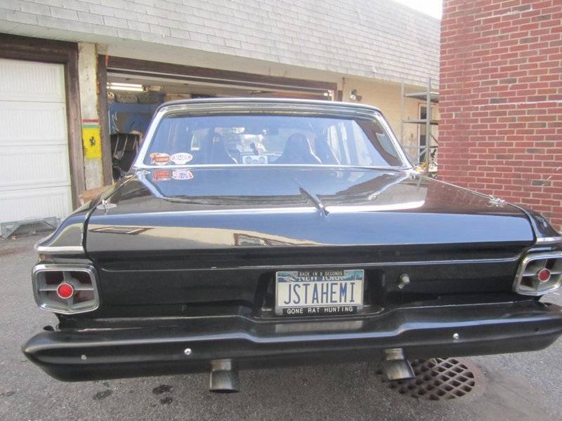

I now have a stainless 4 inch exhaust with an "X" pipe,hooker aerochamber mufflers and tail pipes out the back bumper.No more FUMES in the car!:bananadance:

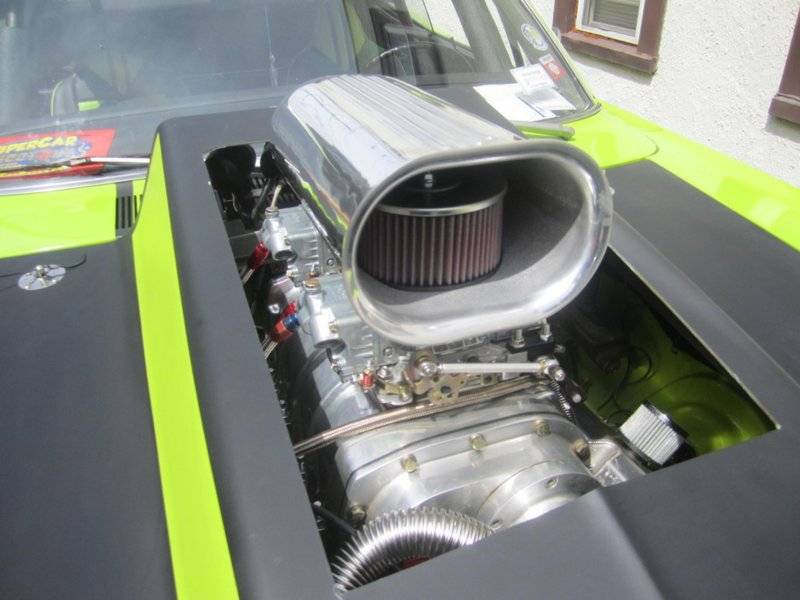

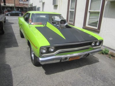

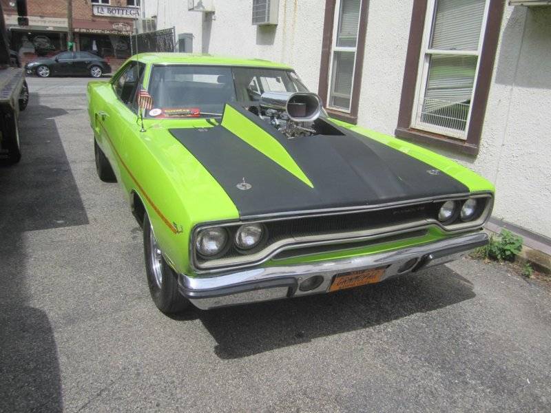

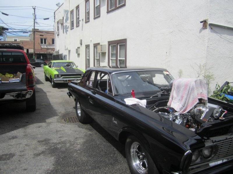

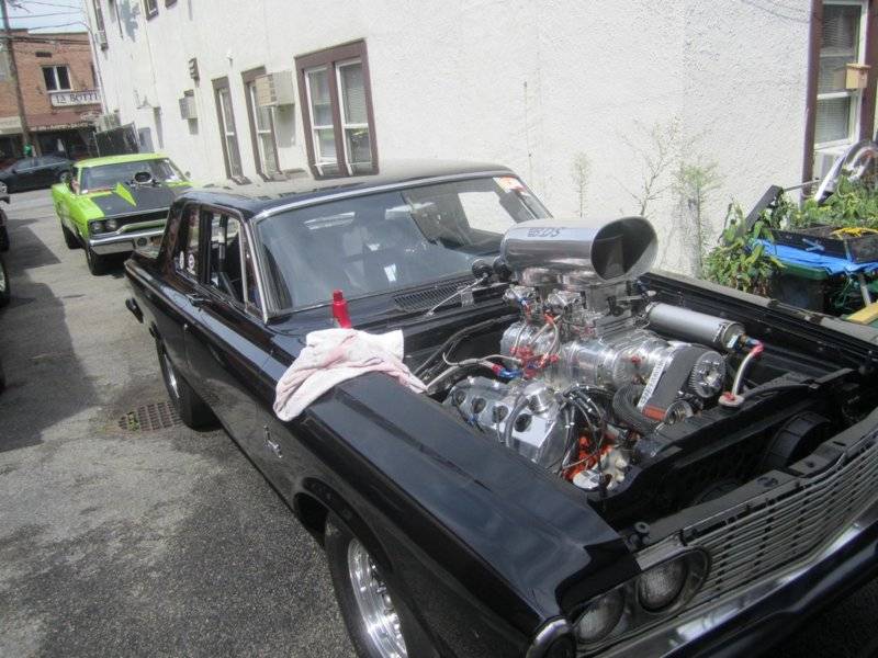

8.8.15 001.jpg 8.8.15 002.jpg 8.8.15 003.jpg 8.8.15 004.jpg 8.8.15 005.jpg 3.13.16 074.jpg
