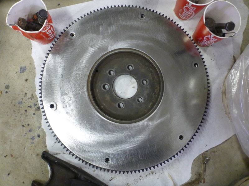

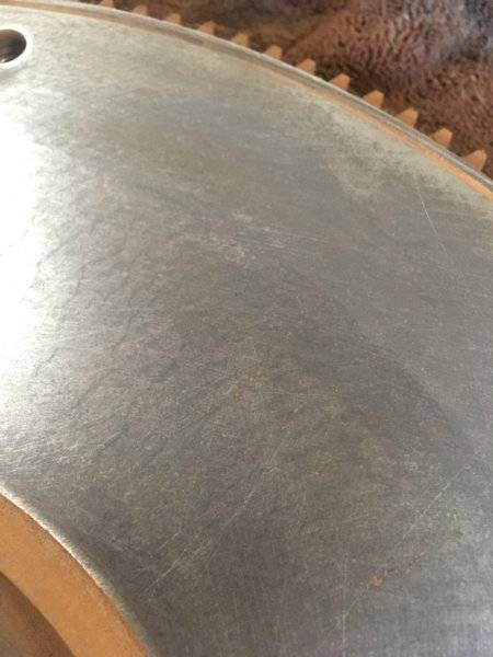

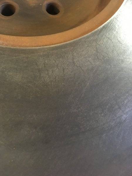

So I was cleaning my flywheel up today to get ready to install. It’s been off the car and in the shelf for about 5 years while doing the resto. While cleaning it I noticed small cracks. I know they’re from heat build up. I can’t feel any with my fingernail they’re just visible. It’s a stock rebuild 383. Would you resurface it and run it? The clutch was just put in when I bought the car and I didn’t drive it but a couple miles before I started tearing it down. So i hate to have to buy a whole new set up. It’s a 11” setup btw.

I like the idea of a lighter weight assembly. My flywheel weighs in about 47lbs. 440 source is 37lbs. Lighter rotating weight means mo power. Here’s some pics of my cracks.

Depends what it looks like after it gets resurfaced ?
just saying..... the heat cracks don't usually propagate too deep and can be removed when surfacing within a reasonable amount of material removal ?
Maybe ask the guy when having it resurfaced for his opinion, and how much he ends up removing.

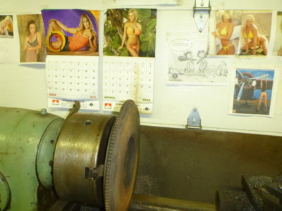

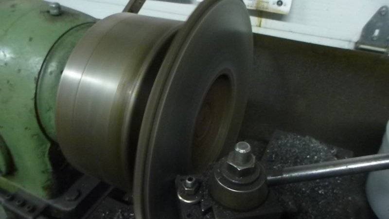

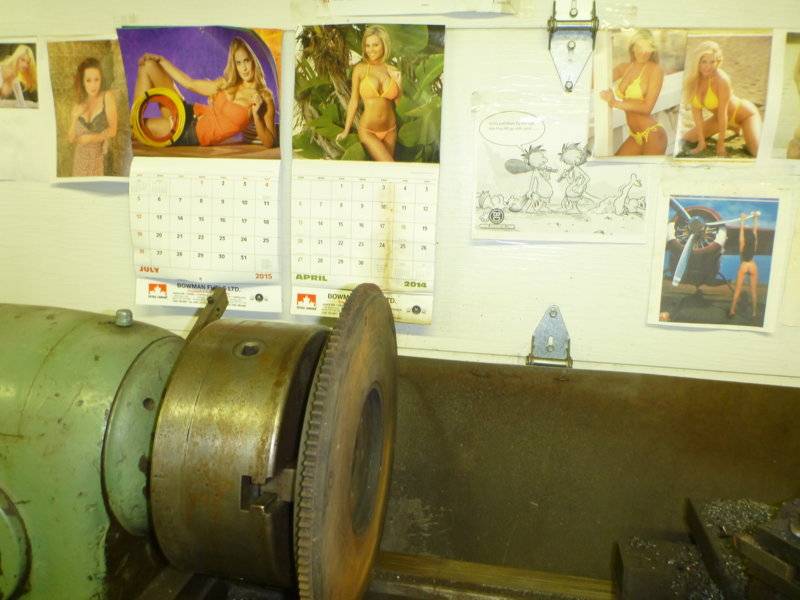

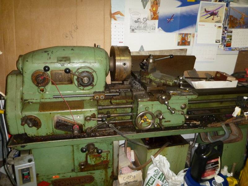

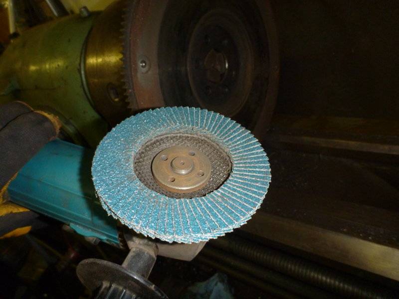

Mine's the same and also looked that way 40 years ago when I was changing clutches. I just threw it in the lathe to resurfaced and reinstalled. Figure I'm basically stock HP and the scatter shield is always there... :rolleyes:
First I turned it and took a skim off to clean any major humps or bumps and then while still turning in the lathe I cross hatched it lightly with the flap wheel. Clutch is chatter free and runs smooth.

Based on your pics, it still looks usable to me....after refinishing, but a light flywheel doesn't mean more power. It just allows the engine to rev quicker. Back in the day, a heavy wheel helped a heavy car get off the line without much losing much rpm at the hit of the clutch. I remember seeing some guys using a light wheel in a heavy car and they usually sounded like the engine bogged if their rpm wasn't up there at the hit....especially with a small block.
