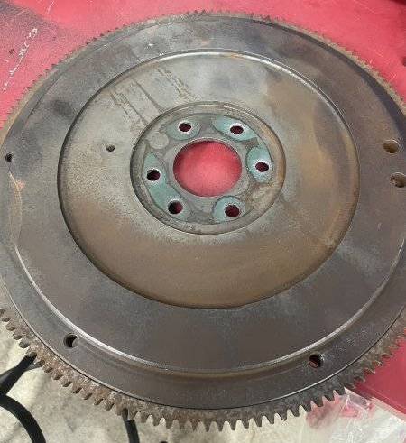

Flywheel rubs against inspection cover
It looks like the flywheel is the problem I would not use that one.
A replacement 143 tooth 11 inch flywheel should be the fix.
It looks to me like the where the flywheel bolts to crank it is counter bored?? If yes, that flywheel is definitely the problem. You could have someone cut some off the engine side to gain clearance, but then it would need re-balanced...and I would question ring gear/starter location.
Dan i may be calling you to order another flywheel too.

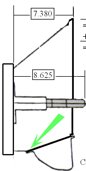

Does your pan forward face angle toward the rear?
If so, maybe a shim at the arrow?
We’ve discussed shimming various locations and even shimming or using a spacer between the crank and flywheel but id like to get to the bottom of it and solve the problem rather than shimming.
I do appreciate the comment. We’ve discussed it. Just hate to shim something then put the motor in and have other but related issues.
Make a shim for the flywheel, to fit tight in that counterbore...
That is an option. Thanks. But, makes me nervous.
Want everything as it should be. Guess I don’t under why who ever had this car before me did this.

Ordering a new flywheel today.
Thanks to all who participated. I don’t know flywheels very well and would’ve never thought to look at the backside and btw most photos of flywheels for purchase don’t show the engine side.
Anyone know or have any idea why this flywheel is like this????

I wonder if the flywheel may be out of an early long crank engine.

So, what does right as rain mean? New flywheel is the same as the old one or now everything fits? Problem solved?
New fly wheel did not have a recess on the back of it so flywheel no longer interferes and rubs on the inspection cover. The old flywheel was the issue but still don’t know why that old flywheel was used or what it’s from.
